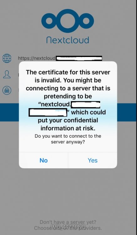

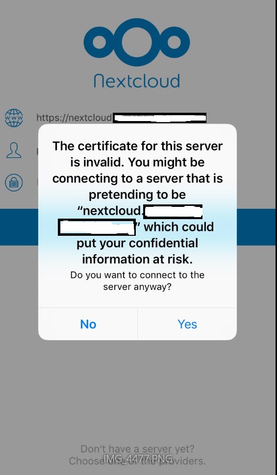

Hi, re-visiting nextcloud and still trying to get it to work properly. I can access from IE after I get a page saying "there is a problem with this website's security certificate" and I press continue on.
Likewise, when I access from my iphone, it seems to work correctly, albeit after seeing this page first:

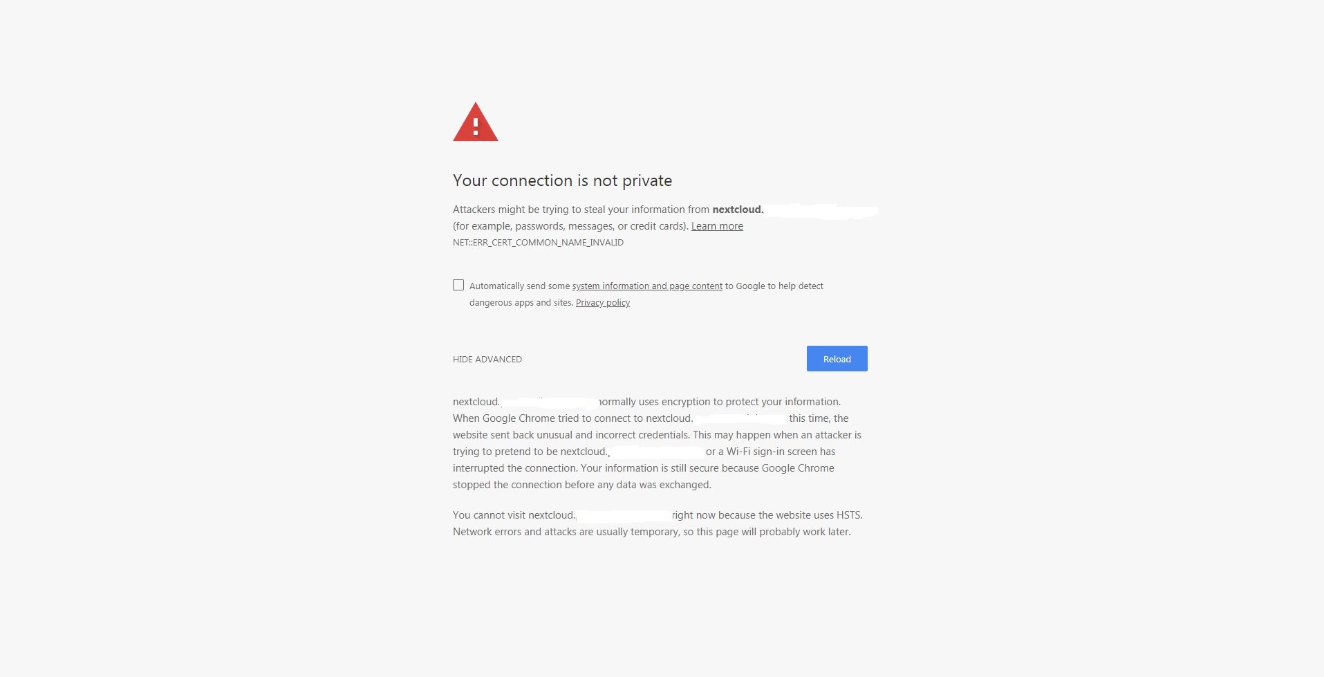

However, when I try to log on in chrome, I get this and can't get past it to the log-on page. Any ideas? Is it a letsencrypt issue? Thank you!
Edited by puncho
Link to comment
You enabled hsts so Chrome refuses to connect unless the cert is valid.
Post your logs and reverse proxy configs and we'll take a look.
Link to comment

14 minutes ago, puncho said:
Thanks for your help!
Here's the letsencrypt log
The letsencrypt config is as follows:
Your cert doesn't cover a "nextcloud" subdomain. In fact it doesn't cover any subdomains underneath the custom one you got from duckdns. You probably should have read the instructions in the container settings right underneath the url and subdomains fields
Link to comment
I think I fixed it, it works now without any messages in chrome/iphone/IE. I had originally followed cyanlabs so I didn't enter the nextcloud subdomain in the container settings. Sorry, pretty noob at this and just follow tutorials to get things up and running.
Here's the new logs...not sure what the new error is about? Thanks again

Link to comment
Again, please read the instructions.
It literally says underneath that field that if you're using a dynamic dns address, the URL should be customsubdomain.domain.url so for you it would be test.duckdns.org and for SUBDOMAINS you can put nextcloud and anything else you like. Also uncheck subdomains only because you want the cert to cover the url as well.
I'm not sure what the error was, but it could be due to inputting the subdomain like that.
Link to comment
Thank you, seems to be all working error free now :)
