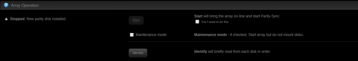

Where do I tell it to "trust parity" so that i rebuilds the data that was written directly to parity during the time the disk was offline?  I don't see an option on the start array section.  Currently it say "Stopped. new parity disk installed"
I assume this is done via the Tools==>New Config.  Reassign drives as before but now I should see the option.  Scary based on the warning on the New Config page. But I take it this will force the drive in question to start reconstructing off the parity information.
Do this:
-tools -> new config
-assign all disks, double check parity disk is on the parity slot
-important, check the box "parity is already valid" before starting array
-start array
-stop array
-unassign the problem disk (select "no device") and start array
-check that the emulated disk mounts and data looks OK
-if all looks good, stop array, re-assign disk and start array to begin rebuild
