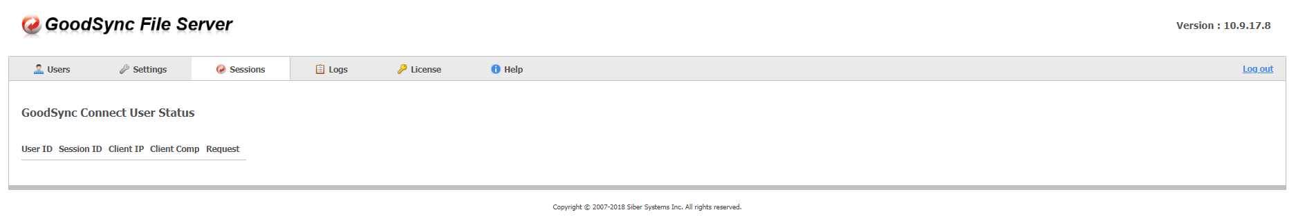

Hi ,  i'm new to unraid and i'm stick with goodsync too.
I have 1 linux nas V10 licence and 1 V10 windows and I don't know  how to make it work.
