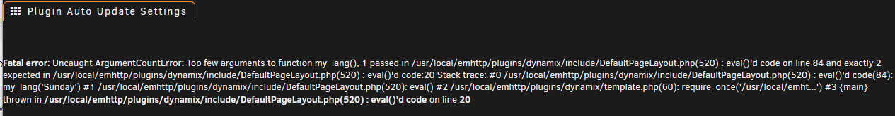

April 6, 20206 yr Author 2 hours ago, nas_nerd said: Hi, I just got his error after being prompted to update to the latest version of CA whilst I was in the Auto Update Applications settings menu. A banner popped up at the top the screen prompting me to update CA to latest version - I clicked update - updated successfully - now I get this error each time I go to the Auto Update Applications setting. unraid-diagnostics-20200406-0632.zip 168.92 kB · 0 downloads Check for updates

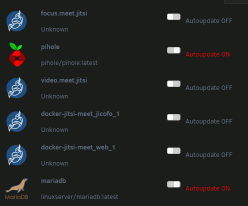

May 7, 20206 yr Running into an issue in the update docker section. I had some old containers installed that I have since removed but they are still showing in this plugin and have an unknown status. Don't know where to clean this up. I've attached a picture.
May 7, 20206 yr Author Beyond recreating the docker.img, not quite sure what to do there. Maybe advanced view on the docker page and delete them from there if they show up? unRaid's underlying system *thinks* that they're still there.
May 7, 20206 yr Yeah I did check the advanced view and removed anything that was orphaned but those were not some that were still there.

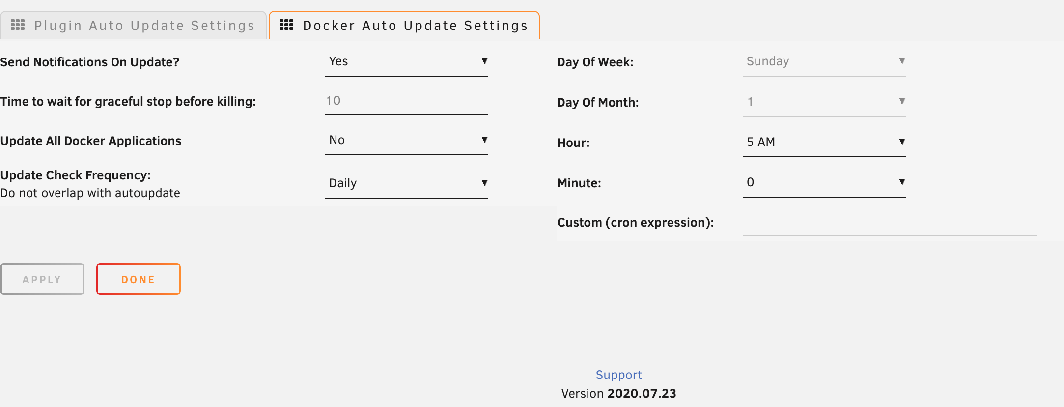

July 23, 20206 yr Hello @Squid, I am one of the Spanish translators and I have a question regarding this plugin. I understand that the phrase in the Docker tab "Do not overlap with autoupdate" means that the frequency shouldn't overlap with the Plugin update check frequency. Am I wrong? Thanks! Edit: Also, to have it perfectly translated you should include in the file the words Disabled and Custom (to match the gender correctly), and I don't know why but the different days of the week are not being translated.
July 23, 20206 yr Author The overlap message is indeed referring to frequency. I'll look at the days not translating. Thanks.

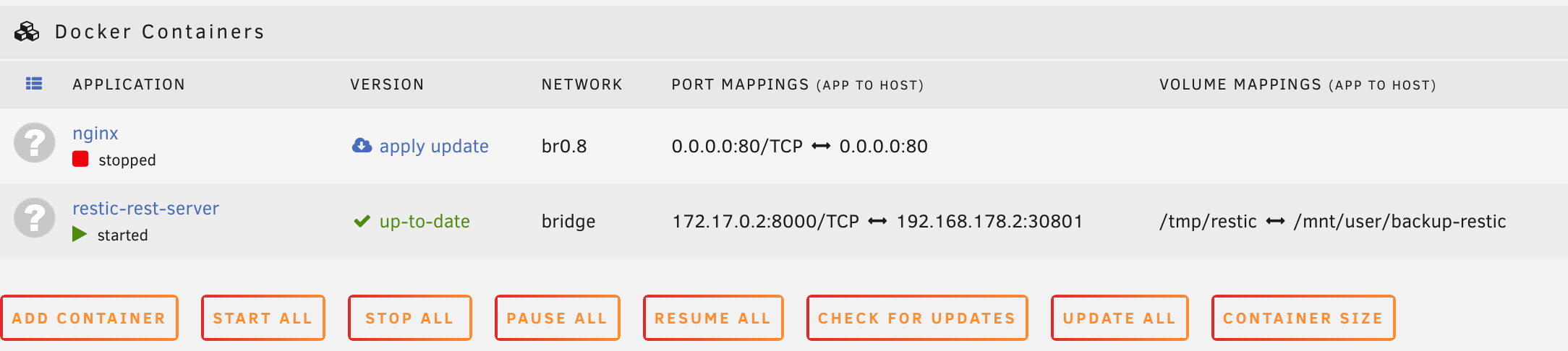

August 12, 20206 yr I just installed this plugin and it doesn't seem to register any Docker containers. I have one stopped and one running, but the settings page is empty: Not really sure how to proceed… can I help debugging this in any way?
August 12, 20206 yr Author My first guess is that if you're running an ad blocker (or any other browser add on) to white list your server. Or, does it work if you use a different browser?
August 12, 20206 yr Doesn't look like it. Neither Safari nor Firefox seem to block anything, also no errors in the consoles. The unraid host is whitelisted in Firefox too. Edited August 12, 20206 yr by Strayer
August 12, 20206 yr Author Are these ones you've installed without filling out a template? Try filling in the "Registry" entry when you edit the container.
August 12, 20206 yr 2 hours ago, Squid said: Are these ones you've installed without filling out a template? Try filling in the "Registry" entry when you edit the container. That worked! I had to set the "Docker Hub URL", then the container showed up. Thanks for the help!
