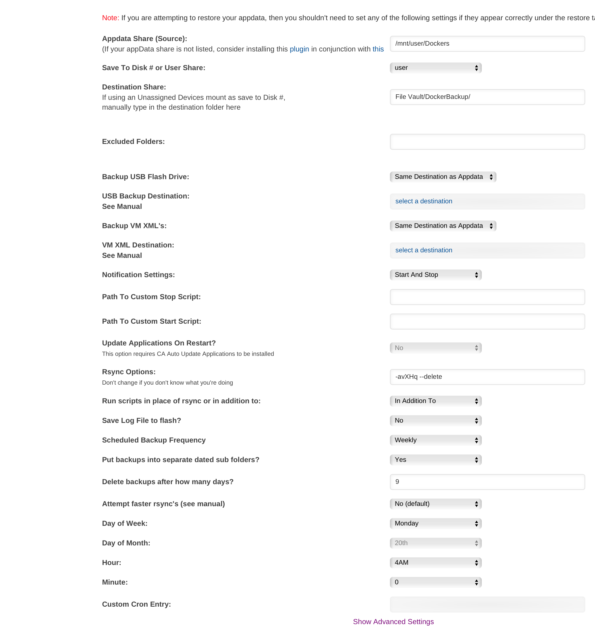

I've actually had the same thing occur to me. WebGUI is completely unaccessible. Can SSH though. Have to do a hard reboot. My log is 38.7MB so a little too big for upload. Is there something in there that you'd like to look at in particular? Let me know if I can supply any other info.
M/B: Gigabyte Technology Co., Ltd. - F2A88XM-D3H
CPU: AMD Athlon™ X4 860K Quad Core @ 3700
Memory: 8 GB
Unraid:               6.3.1
Settings:
58d9ab219c96c_ScreenShot2017-03-27at7_14_12PM.thumb.png.9965959219db759ff8939dd317f75255.png
Start of Log:

Your's finished.  IE: nothing of interest there...  @MickMorley's did not.  But the system kept on chugging away.  That's what's making me curious.
I did just start a backup on my system, and invoked mover several times, and it finished no problems.

Can you show me a screenshot of Settings - Docker Settings (Click Advanced in the top right)
Here you go, I had to screenshot it from my phone. 691398b811f6878193f125b912cb9d9f.jpg
Share this post
Link to post
Well that blew away the only theory I had...
Here's what's going on:
The rsync started and was carrying on no problems.  Then, up in the middle of it it just decided to quit.
This is probably because something somewhere killed off CA's backup script.  Except all of this happened without any errors or notifications or anything being logged anywhere.
There have been intermittent reports of mover crashing (also uses rsync), but AFAIK no one has ever adequately explained why or how.  This is a built-in command to linux, and is not an add-on at all.  But the messed up thing is that if you run it manually, it runs to completion.
My suggestion on how to fix you're probably not going to like:  Easter is coming...  Take the server with you on Easter Sunday to your local church and get it blessed along with all of your food for the dinner....  It's possessed.  >:D
IE:  I have no clue what's going on, nor is there anything I can do about it.  The cause is not within CA Appdata Backup.
EDIT: Not quite true.  I have a feeling that php is getting Bus Errors causing complete abnormal exits (may be a bug in php7) (does anything appear on the locally attached monitor?), but either way it's way out of my purvue.
