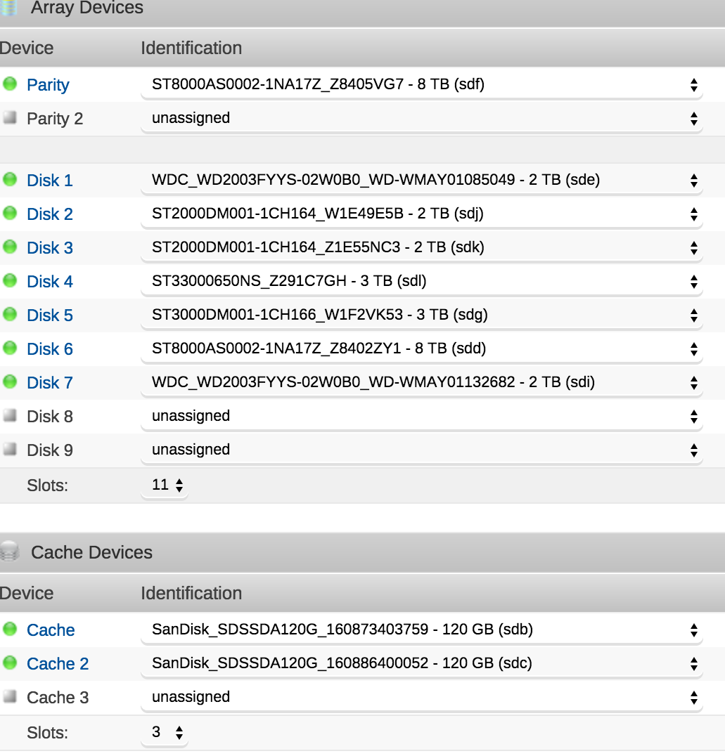

I've also attached a picture of my drives.

Which seems like drive 6 is failing? But why wouldn't the array just start with that drive in a 'failed' state?
