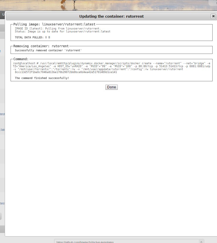

also i tried deleting the rutorrent container and now all new  installs of rutorrent fail i have tried deleting the files from app data and reinstalling multiple releases of rutorrent to no avail

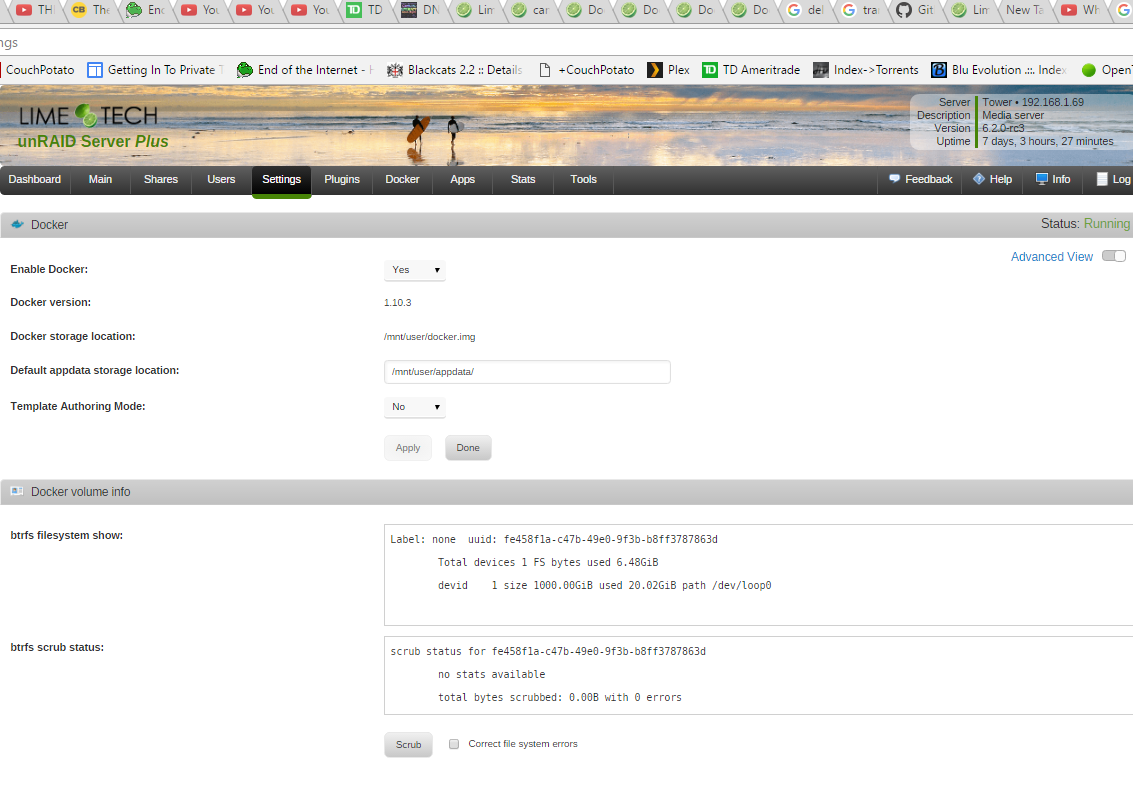

In addition to the screenshot mentioned in that link I gave from the FAQ, also post a screenshot of Settings - Docker.
here you go thanks
and the next
Never seen a 1TB docker.img. Been quite a while since I set up my 20GB docker.img, and I'm not sure if it makes any sense to put it at /mnt/user or not. It used to be you had to put it on a specific drive. Do you have a cache drive?
yea a 128gb ssd
Stop the Docker service by choosing Enable Docker: No. Then it will let you delete docker.img. Then set its path to /mnt/cache/docker.img. 20GB should be more than enough.
