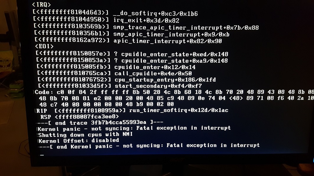

This is my first go round with Unraid coming from FreeNAS.  I was able to get everything running with 2 HD Red 3TB drives and a Kingston 240GB SSD for a cache.  Everything seemed fine until I tried to run Plex.  I was getting constant buffering trying to only run one stream locally in my house.  The Xeon processor should be able to handle that and it worked fine when I used it in FreeNAS.  I was also getting reboots to the system at random times.  I decided to try a different flash drive to boot UnRaid from.  After this when I started building my parity, I got around 150MB/s.  Around the 2TB range, however, it drops to around 9MB/s and shortly after the server is offline.  This morning I got a picture of the error message (attached).  I'm thinking this could be bad RAM, but after a week of struggles thought it was time to call in the experts.

Start with a long Memtest (it's on the boot menu), although you may want to try the more updated PassMark Memtest (needs a bootable prepared).
I removed all but one 4GB stick and the system is screaming fast.  I just need to figure out now which stick(s) are bad.  Thanks!
