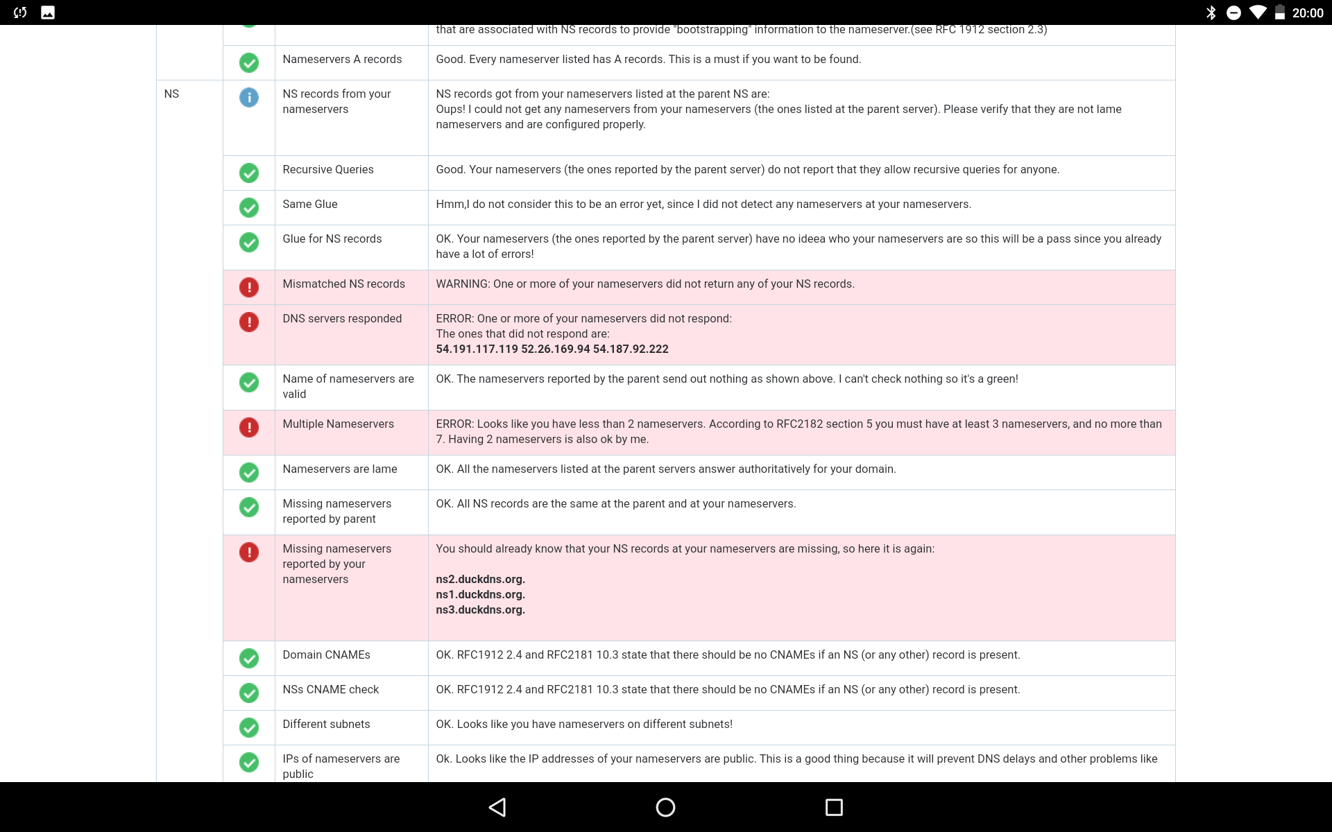

Anyone else having issues today? It appears that DuckDNS is offline this morning.
yeah, it's down for me too.
It seems they're having dns propagation issues at the moment so dns may not be resolving.
With the pandemic and most people working from home, cloud service reliability has gone down across the board.

Sure, did point previous posters to the reason of their problems. The link in my post can help to identify problems on duckdns side as they don't have a status page AFAIK.
My bad, missed the link
