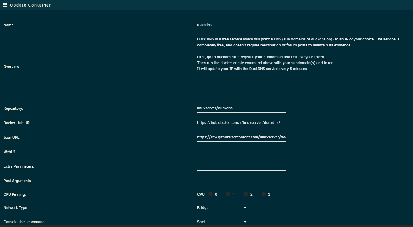

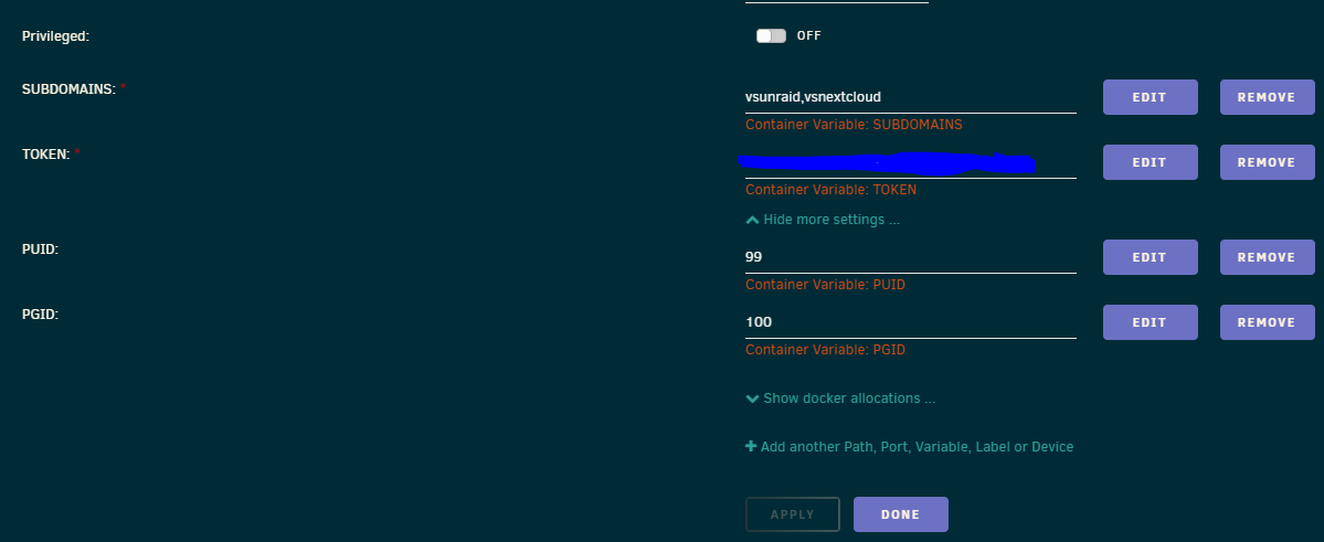

Hi everyone,
I'm a full blown noob when it comes to UnRAID (come from OMV on top of Debian), and am still at the very beginning of my learning curve (not even sure it's a curve yet, more like a flat line).
Here's the situation I've hit myself in the face with:
I have full access from the internet to my Nextcloud (as does my wife, don't want any trouble there), however, when I try to access my UnRAID web page, all I get is a "Welcome to our server" message;
This is my DuckDNS docker configuration:

Don't try to access Unraid that way. Setup the built-in Wireguard VPN
Thank you so much.
Now I have a direct tunnel into my house form each of my devices when traveling.
So far UnRAID is working much better and is more solid than any of my previous OMV instances.
Plus, the response from the community (granted, this was my first reaching out) is much faster and to the point.
