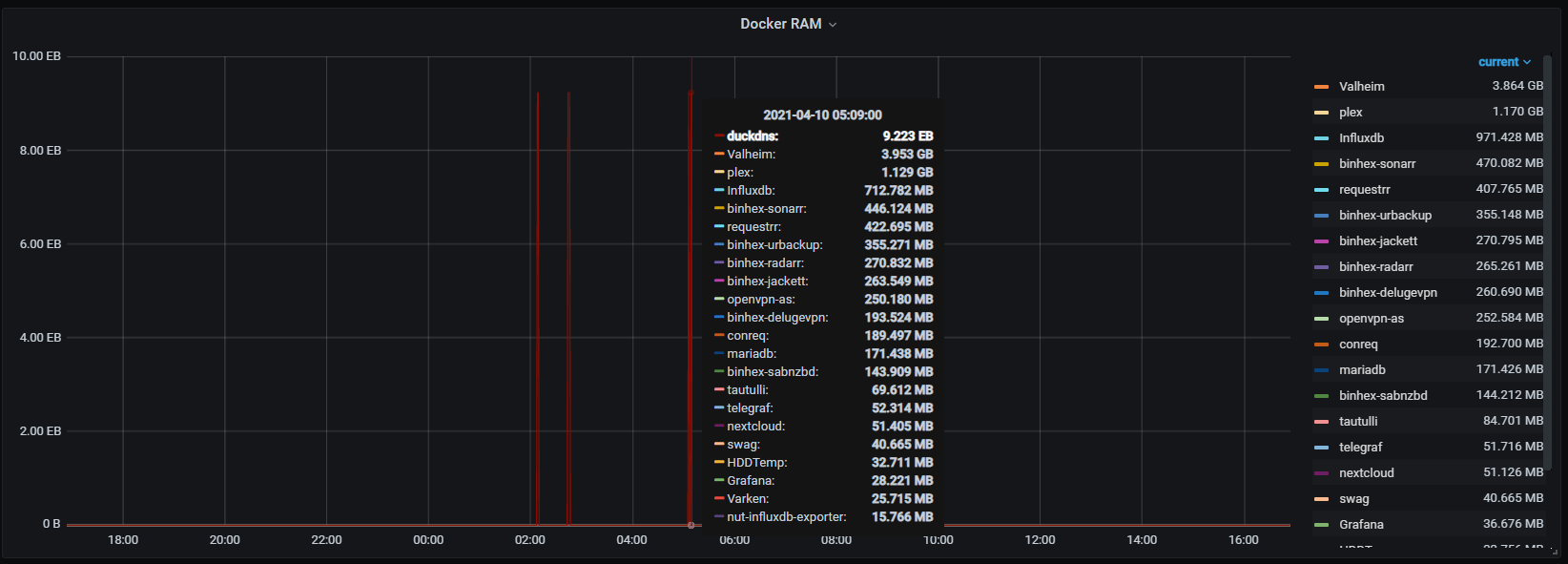

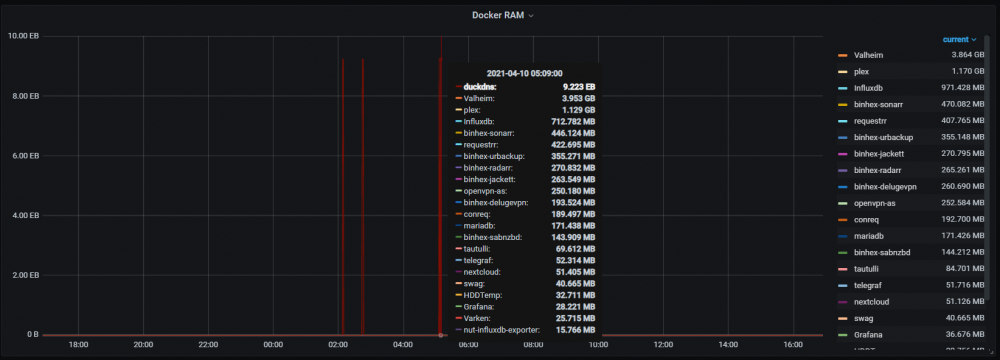

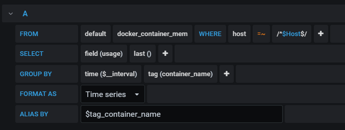

Not really a big issue but does anybody know why my DuckDNS container would be mis-reporting a use of 9 Exabytes of RAM? I'm not getting any errors in the log at the time these spikes happen so I'm not worried it's broken, just is mildly annoying/funny because it makes my status graph unreadable as it scales Y to account for the spike:
EDIT: This is the Grafana query used to source the data from Influxdb:
And I believe this is the only portion of the telegraf.conf file that would collect memory usage data:
Edited by scd780
