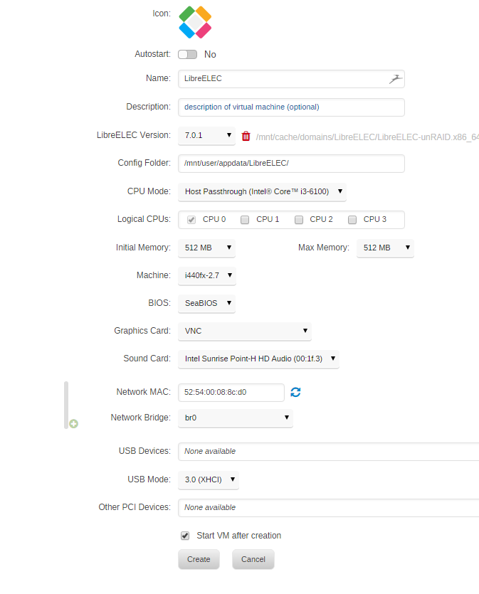

Hi , I am testing 6.3.0 rc4 an trying to pass thru the (onboard)sound card but get the following error :
internal error: process exited while connecting to monitor: 2016-11-18T10:28:18.793297Z qemu-system-x86_64: -device vfio-pci,host=00:1f.3,id=hostdev0,bus=pci.0,addr=0x8: vfio: error, group 10 is not viable, please ensure all devices within the iommu_group are bound to their vfio bus driver.
2016-11-18T10:28:18.793321Z qemu-system-x86_64: -device vfio-pci,host=00:1f.3,id=hostdev0,bus=pci.0,addr=0x8: vfio: failed to get group 10
2016-11-18T10:28:18.793333Z qemu-system-x86_64: -device vfio-pci,host=00:1f.3,id=hostdev0,bus=pci.0,addr=0x8: Device initialization failed

You wont be able to pass that through when there are other things in the same IOMMU group.
If youve not enabled PCIe ACS Override in Tools>VM settings, give that a try and see if it gets its own IOMMU group. If not, you'll not be able to pass it through to a VM.
You'll need a seperate PCIe sound card (choose carefully, Some dont play nice). Or if you pass through a PCIe USB card, use a USB DAC instead connected to a port on there instead.

I have bought a Asus Xonar ( C-Media Electronics Inc CMI8788 [Oxygen HD Audio] | Multimedia audio controller ) and everthing is working :-)

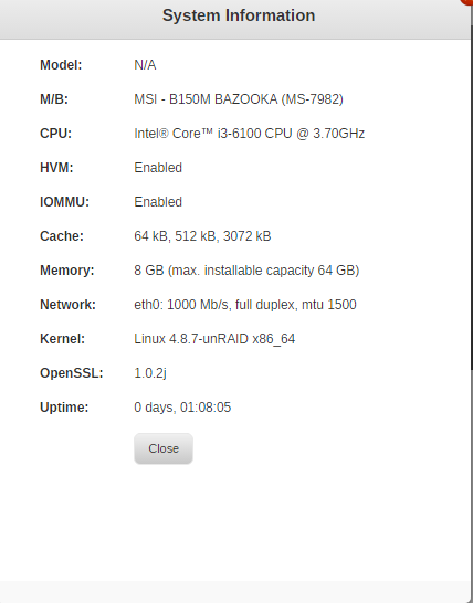

My mobo is an B150M-BAZOOKA.
