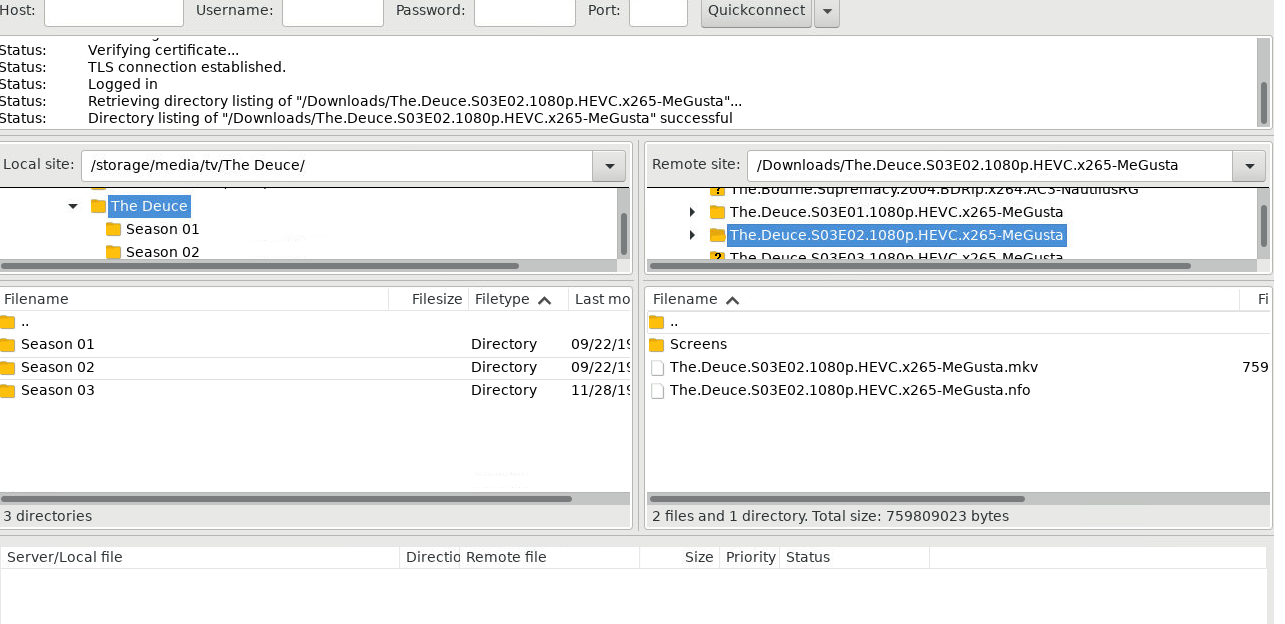

Great app, but I can't make a filter work. I'm trying to download "The.Deuce*" files from my seedbox, and I have setup two schedules, 1 for "*Deuce*" and 1 for "The.Deuce*", and both say that there are no files that match that filter, and move on. I'm attaching my davos.log, and I hope that will help you help me. Thanks very much.
Looking at the logs it seems that it did initially pick up the files based on the filter, but there was an error when attempting to download one of the metadata files. By default davos will try to continue with the workflow but will register all attempted files as having been actioned, so following runs of the schedule will ignore the files. That's why it appears the filter isn't working (it is, it's just ignoring them because it thinks it's seen them before).
For some reason davos is unable to create the local directory for some sub folders when recursively downloading the files. If you look at line 1109 onwards in the logs you provided, you'll see the schedule picks up the files and then goes over each of the matching directories. In order to download the directories, it needs to traverse them over FTP and then generate them locally by manually creating them (you can't transfer directories over FTP using the Java libraries I use). However it seems that is is unable to create these directories locally "2019-11-29 08:51:54.107 - DEBUG - [FileUtils] - Directory was not created!".
Check your directory permissions for /downloads/Downloads and make sure that is is a) a valid directory, and b) owned by the correct user.
If you want to test the schedule out again, you can click on the history icon in the schedule summary and clear the list. This will force davos to fully match everything again.
Makes sense. I had the download directory set incorrectly at first, and this queue was made to download before I changed the directory setting. After clearing the list of files it's started downloading.
