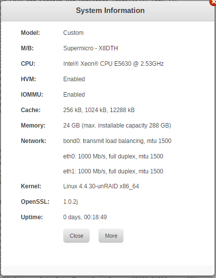

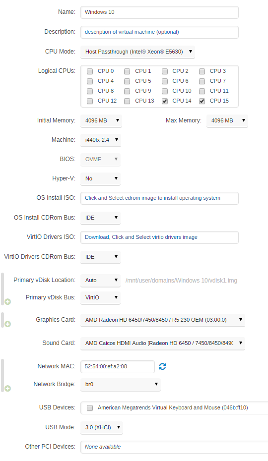

I've switched compute infrastructure and a card that previously worked on passthrough now gives me errors. I've done all the standard troubleshooting and fixes that I can find new or had to use the last time, but now I'm stumped. Open to suggestions or just an extra pair of eyes to see if there's something I missed.
Here's the standard troubleshooting bits..
supermicro bios is set to use the onboard VGA. vt-d is supported and enabled. I've moved the card around to the various PCI lanes that I can, but some are physically unavailable due to the layout of the board and card dimensions.

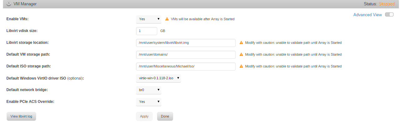

ACS override is enabled.

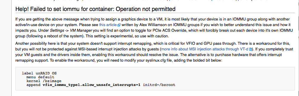

I've applied the hotfix, even though my domain.img was the same 3MB size as the hotfix. I also replaced the qemu.conf file. http://lime-technology.com/forum/index.php?topic=44010.0
internal error: early end of file from monitor, possible problem: 2016-11-22T06:00:03.567169Z qemu-system-x86_64: -device vfio-pci,host=03:00.0,id=hostdev0,bus=pci.0,addr=0x5: vfio: failed to set iommu for container: Operation not permitted
2016-11-22T06:00:03.567211Z qemu-system-x86_64: -device vfio-pci,host=03:00.0,id=hostdev0,bus=pci.0,addr=0x5: vfio: failed to setup container for group 15
2016-11-22T06:00:03.567219Z qemu-system-x86_64: -device vfio-pci,host=03:00.0,id=hostdev0,bus=pci.0,addr=0x5: vfio: failed to get group 15
2016-11-22T06:00:03.567231Z qemu-system-x86_64: -device vfio-pci,host=03:00.0,id=hostdev0,bus=pci.0,addr=0x5: Device initialization failed

<domain type='kvm'>
  <name>Windows 10</name>
  <uuid>5fe54bda-e986-cbd1-3eee-25dcf4021286</uuid>
  <metadata>
  </metadata>
  <memory unit='KiB'>4194304</memory>
  <currentMemory unit='KiB'>4194304</currentMemory>
  <memoryBacking>
    <nosharepages/>
    <locked/>
  </memoryBacking>
  <vcpu placement='static'>2</vcpu>
  <cputune>
    <vcpupin vcpu='0' cpuset='14'/>
    <vcpupin vcpu='1' cpuset='15'/>
  </cputune>
  <os>
    <type arch='x86_64' machine='pc-i440fx-2.4'>hvm</type>
    <nvram>/etc/libvirt/qemu/nvram/5fe54bda-e986-cbd1-3eee-25dcf4021286_VARS-pure-efi.fd</nvram>
  </os>
  <features>
    <acpi/>
    <apic/>
  </features>
  <cpu mode='host-passthrough'>
    <topology sockets='1' cores='1' threads='2'/>
  </cpu>
  <clock offset='localtime'>
    <timer name='rtc' tickpolicy='catchup'/>
    <timer name='pit' tickpolicy='delay'/>
  </clock>
  <on_crash>restart</on_crash>
  <devices>
      <source file='/mnt/user/domains/Windows 10/vdisk1.img'/>
      <boot order='1'/>
    </disk>
    <controller type='usb' index='0' model='nec-xhci'>
      <address type='pci' domain='0x0000' bus='0x00' slot='0x07' function='0x0'/>
    </controller>
    </controller>
    <interface type='bridge'>
      <mac address='52:54:00:ef:a2:08'/>
      <source bridge='br0'/>
      <model type='virtio'/>
    </interface>
    <serial type='pty'>
      <target port='0'/>
    </serial>
    <console type='pty'>
    </console>
    <channel type='unix'>
      <source mode='connect'/>
    </channel>
      <driver name='vfio'/>
      <source>
        <address domain='0x0000' bus='0x03' slot='0x00' function='0x0'/>
      </source>
    </hostdev>
      <source>
        <address domain='0x0000' bus='0x03' slot='0x00' function='0x1'/>
      </source>
    </hostdev>
    <memballoon model='virtio'>
    </memballoon>
  </devices>
</domain>
Is there something obvious I'm missing?
What version of unRAID are you using?
I see that you are using pc-i440fx-2.4, If I rememberi440fx-2.5 came with unRAID 6.2 and now with 6.3 rcs we are on 2.7.
So I guess you are using 6.1.9 yes? If so I would upgrade to the lastest stable version and follow the steps for the upgrade when it
comes to VMs. Then see where you are afterwards
I'm on 6.2.4 and was just trying different versions of i440fx to see if there was any change (there wasn't).

OK please try these steps
1. stop the array
2. click on settings
3. click VM manager
4. toggle to see advanced settings
5. then delete /libvirt/libvirt.img and click done
6. restart the array.
7. old VM templates that use OVMF will not work now as their NVRAM files will be gone, so you need to
  create new VMs.
Try this. Hope it helps
Please clarify step 5. I edited the path to remove /libvirt/libvirt.img and that just broke the VM module due to invalid path, as did removing the path entirely. So I renamed libvirt.img to libvirt.img.old and restored the path settings so that it could recreate the img file , but I get the same error when creating a new VM from scratch and try to assign the video card to it.
Sorry made a mistake should have said disable vms not stop array. my bad.
1. click on settings
2. click VM manager
3. toggle to see advanced settings
4. enable vms..... choose no
6. enable vms.....  check yes
  create new VMs.
Steps followed, reconfigured a new VM with VNC, switched over to the AMD GPU and same error.
After going through much of what you have, I had to use the following to get my gpu working on my server. It might be needed due to hardware limitations/differences.
Wow, this did it. Thanks! I thought I had done a good job searching, but I never came across this tidbit - oh well.
It took me a while to find it the first time. Many, many days of just trying to figure out why my GPU wouldn't work. And then after I did a reinstall of 6.2 a few days ago, it took me a while to find it again. So I took the screen shot (that I had posted) and put in in a folder titled "GPU PROBLEMS : failed to set iommu for container" so I could easily locate it again.
Glad to know it worked out.
