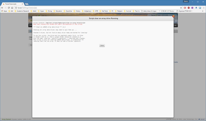

So I have tried that and it doesn't work. The folder is created on the drive but the script reports "Checked 5 drives, did not find an empty drive ready and marked for clearing".

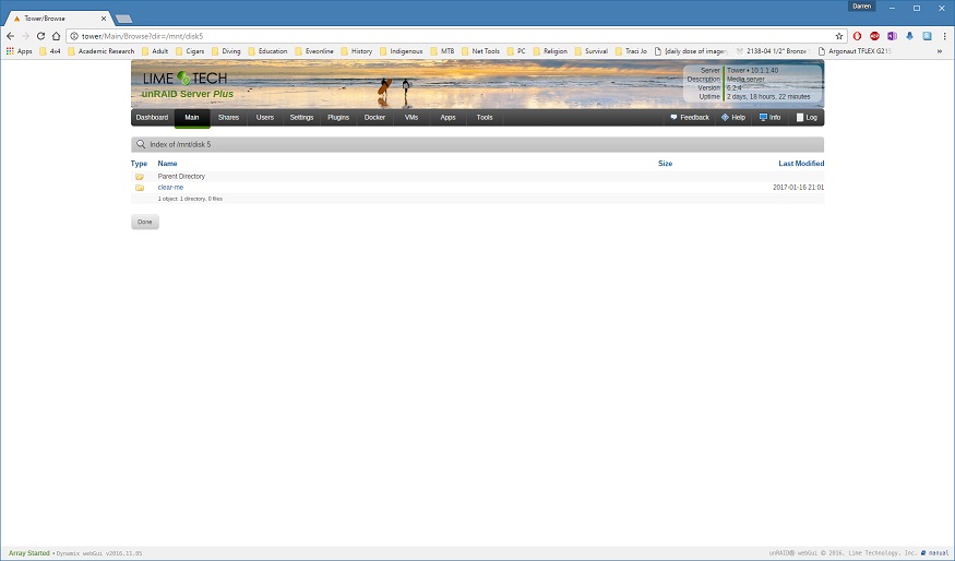

However after I format the drive there is a folder called "Parent Directory". It appears regardless of the FS I select.
At the moment, the drive has two folders, "Parent Directory" and "clear-me". Is there a way to format the drive without the "Parent Directory" folder from being created?
Parent Directory is not a folder, if clear-me is the only folder the script should clear it.

I have attached an image of the view of the drive I am trying to delete as well as an image of the script message.
Looks correct, don't know why the script isn't working.

I imagine that by now you've cleared the drive, and it's no longer available for testing?
There are just 2 simple tests run to verify the drive is ready for clearing (assuming it's for Disk 5) -
* ls -A /mnt/disk5 - which should return exactly and only clear-me
* du -s /mnt/disk5 - which should return a string whose very first character is zero
Any other return fails the tests.  These have worked for me and others, and yours is the first report that it didn't work.  These tests are double checks that the correct drive has been deliberately emptied, and deliberately marked as available for clearing.  We've had a few users in the past that misunderstood directions and warnings and wiped the wrong drive, or assumed this procedure would save their data.  It doesn't!  It wipes it out, and since parity is updated too, the data cannot be recovered, even by a data recovery service.
I'd want to check whether these simple standard Linux commands have been changed in the newer Linux distros, and are returning a different syntax with the newest unRAID releases.  I really doubt that's true, but it should be checked.  I don't know when I can test that for myself though.
I noticed one oddity in your first picture.  It shows the correct path in the browser location box, but adds a space within disk5 in the title of the file listing area.  Most likely a display styling thing ...  but inconsistent!  (I don't like replacing the traditional '..' with 'Parent Directory' either!)
Yeah, sorry mate. The process that johnnie.black wrote worked a charm.
I didnt replace anything with 'Parent Directory'. After I followed the format process it was there. I presumed it was created during the format process.
I followed this step "One quick way to clean a drive is reformat it! To format an array drive, you stop the array and then on the Main page click on the link for the drive and change the file system type to something different than it currently is, then restart the array. You will then be presented with an option to format it. Formatting a drive removes all of its data, and the parity drive is updated accordingly, so the data cannot be easily recovered." When I looked at the drive index after doing the format "Parent Directory" was there.
When I look at my drives now they all have folders called "Parents Directory". Nothing I have done, system created.
About the space within "disk5". All the drives are displayed that way; disks 1 - 4 all display as /mnt/disk *.
No I didn't mean you had done it, the developer that designed the screen apparently added the 'Parent Directory' designation.  There's no parent directory indicator in a real folder directory, it's just an artificial thing added to the display to help users navigate up the directory tree.  But traditionally, it's always been a pair of dots, periods, in DOS, Windows, and Linux.
