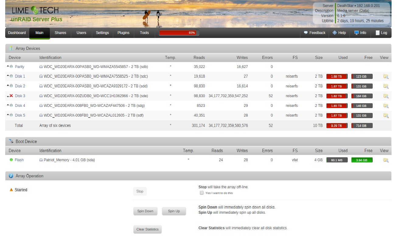

Unraid showed missing disc (pic inside) what do I do?
Run parity monthly on 1st (21 days ago and no errors). I did a clean power down and checked all wires (6 months/year ago unraid didn't want to show parity, checked wires and fixed problem) and thought that might be the issue.
It didn't fix the problem (pic attached) and before I do anything stupid I want to ask how to proceed. The "unassigned Devices" were it has "Sdg WDC_WD20EARXxxxxx" was in the disc 3 spot previously. I didn't kick the PC box, touch any wires, update any software, anything. The only thing that my unraid box does is 1 month parity and watching movies/tv shows, etc...
I believe I can just "STOP ARRAY" and then assign SDG WDC_20EARX to disc 3 (since that was where it was previously) and there isn't a problem? Please instruct me of what to do so I don't make it harder for you guys to fix a bigger problem later.
Thank you

Server was rebooted after the disk failed so we can't see what happened, but SMART for that disk looks fine so you can try and rebuild to the same disk.

Something is up...This is what I found today.
This time I DIDN'T touch anything and just got a screen shot and zip file like requested from a few weeks ago.
1) What is going on?
2) How to fix? (if drive is dead or dying I don't have problem with getting new one and rebuilding)

Disk3 dropped offline, if you haven't yet you can replace that disk cables and try again, if it still fails you'll need to replace the disk.
