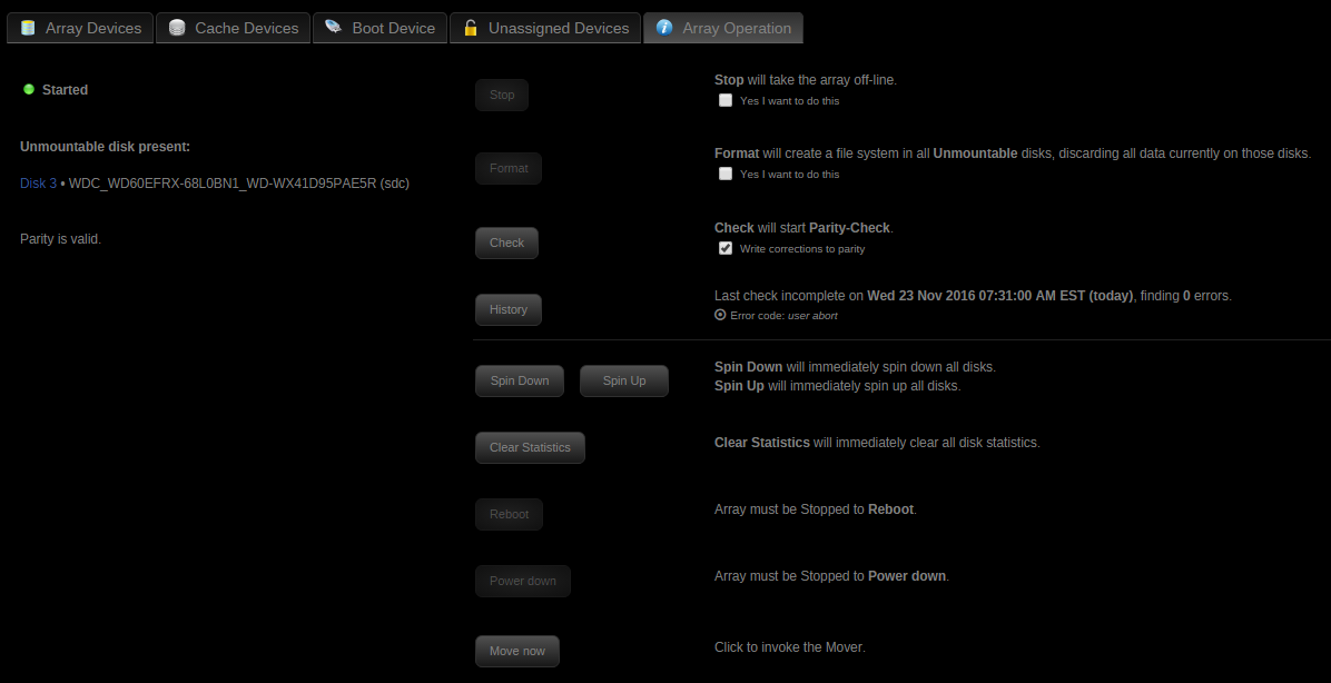

Hi all, having a bit of weirdness with my server....it's been humming along without incident for ages, and i rebooted it for an unraid OS update, and one of my drives came up saying "unmountable - no file system":
The strange thing is it doesn't seem to be showing that the array is in a "degraded" mode (i'm used to seeing it say that it's "emulated" when a drive has gone bad).  I ran SMART checks on the drive and they come back clean.  I know from reading previous forum posts that formatting it is a bad idea since the parity will get rewritten to think that drive is "empty", so i haven't done that.
What are the next steps?
That's not a failed disk, it's file system corruption.
Tools -> Diagnostics

Apologies for the delay in reply - it was a 6TB drive and it took a long time for the XFS repair to run.  Unfortunately, after all that running it spit out ".Sorry, could not find valid secondary superblock Exiting now."
Is it possible to set the drive up as "new" and rebuild it from parity?  If so, what's the best way to go about that?
Also, what is the "best practice" for preventing something like this from happening in the future?
Are you sure used you used the correct command? It should be:
xfs_repair -v /dev/md3
Ah, i misunderstood the directions and used /dev/sda3.  Will re-run with /dev/md3 and report back!
Looks like that got it sorted.  Filesystem was repaired, drive mounted properly, and aside from one 0KB file, the lost+found was empty so i don't think i even lost anything.  Thank you so much!
As an aside, any idea what could've caused this, or what i could do to prevent it in the future?
Probably due to the unRAID upgrade and the newer xfs, can detect previously undetected corruptions, the corruption itself in my experience is more commonly caused by power cuts/unclean shutdowns.
