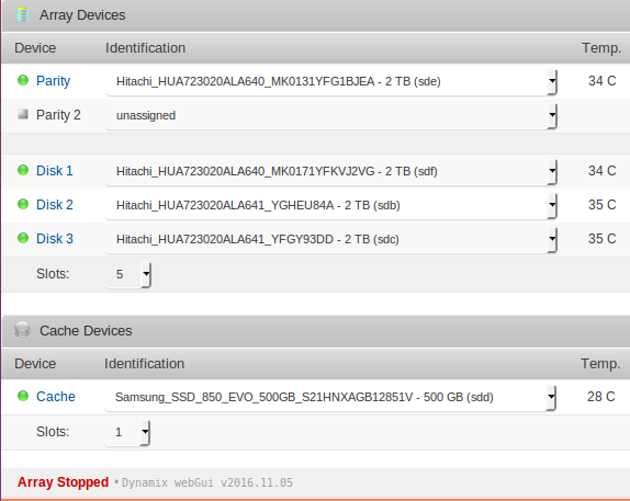

Ok, time to try something different.  I have 2 X 2TB drives sitting in Unassigned Drives.  They have both been pre-cleared and are ready for use.  Recalling the initial message of my disc being full I imagine now is the time to add these disks to the array.  So I stopped the array, grew it from 3 to 5 devices, and added the two precleared discs to Disc2 and Disc3.
When I started the array, it showed Disc1, Disc2, and Disc3 as all 'Unmountable'.
And at that point, I decided my fixes are not making things better, so I shut down the server.  I hadn't noticed any 'red balls' at any stage, and am confused as to what is even happening.  Of course it wasn't until after shut-down that I thought to start taking screenshots.  :-[
Attached are the screenshots of the telnet session, and of the present assigned drives of my array.
That is expected for disks 2 and 3, they need to be formatted, disk1 probably has filesystem corruption.

Yes, disk1 filesystem needs to be checked, disks 2 and 3 need to be formatted, but don't formatted them now your disk1 will also be formatted, so:
re-start array in maitnance mode and run xfs_repair:
xfs_repair -v /dev/md1
After that if disk1 mounts you can formatted the other disks.
