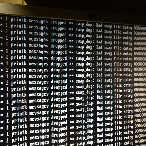

Latest screen before manual shutdown....

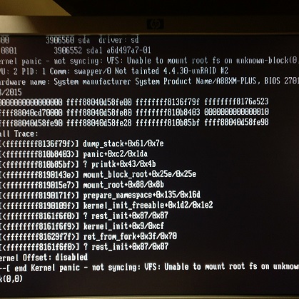

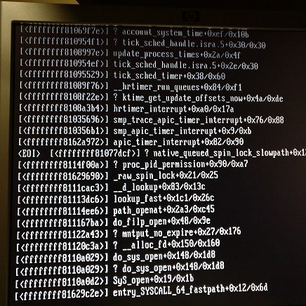

Got tired of my memory/mb problems and replaced with a new A88XM-plus/A8-7600k/Ballistix mem
After normal troubleshooting got stuck with this...
Any suggestions ?
BTW, after this I upgraded BIOS, something got wrong and no POST, no video, nothing at all... but this is another story.
Thanks to all
Well, a few days ago, I spent quite a bit of time studying your diagnostics and syslogs, trying to find something definite, and failed.  I just tried again, and I still can't explain the issues.  It still really looks like a memory problem or a dependency problem, but I could not find any dependency issues, and you've tested your memory (wouldn't mind seeing what the PassMark Memtest could find though).
Your last post on different hardware is also a failure, before unRAID could even boot, a 'kernel panic' with 'unable to mount root fs'.  It's a different problem at least, possibly the boot drive not prepared correctly, which doesn't make sense as it's probably the same one you have been booting with.  Not a likely solution, but do try a different USB port, preferably a USB 2.0 port.
