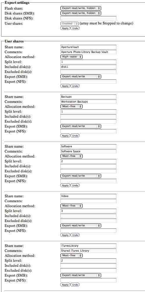

I've attached a copy of 2 of my shares' .cfg files along with a screen shot from the web interface (in case you see anything funny).
For most my shares the only difference is the split level. The only exception is the "ApertureVault" share which forces everything to be on disk1 (don't know if that's a clue or not).

Joe,
Sometimes I just need the right question to change my focus and get me pointed down the right path. I think I stumbled onto the solution for both problems (using the wrong disk based on free space AND throwing an error when copying a large file).
My "Video" share was setup with split-level = 3. Later I added an additional directory level and manually moved the files around to fit into that organization scheme (on both disks). But I did not change the split-level. When I try to copy a file to "Video/Library/Movies/Rated PG" it finds a "Rated PG" folder on disk1 and since it's already below the split-level I think it disregards the free space thing and starts copying there. I'm sure I over simplified it, but could that explain why it always went to the same disk (regardless of the free space)?
What I can't explain is why it caused the copy to drag down to such a slow speed (which I suspect is what caused the error to get thrown). As I mentioned above, copying files with FTP was painfully slow but it would eventually succeed.
In any case. I set the split level to 4 and it all works as before. It chooses which disk based on free disk space and the drag-and-drop copies are as fast as they ever were. I know "fast" is relative (I don't have a cache disk), but it's an acceptable rate of around 1GB per minute (wall-clock time). I just copied around 20GB and it chugged along just fine. No errors, checksums are good, etc.
