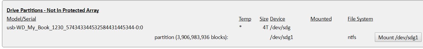

OK, with the WD My Book plugged into a USB port, I can see it in the "Non protected array"
But I see 2 lines actualy:
Drive Partitions - Not In Protected Array
Device Model/Serial Mounted File System Temp Size Used %Used Free
/dev/sdg usb-WD_My_Book_1230_574343344532584431445344-0:0 * 4.00T
/dev/sdg1 usb-WD_My_Book_1230_574343344532584431445344-0:0 *

In Disk Management, I get this (see attached)
That will be your capacity, then: 3,906,983,936 blocks, so multiply by 1024 to get the total number of bytes: 4,000,751,550,464 bytes. Now compare that with a normal internal 4 TB disk. I don't have any, I'm afraid.
