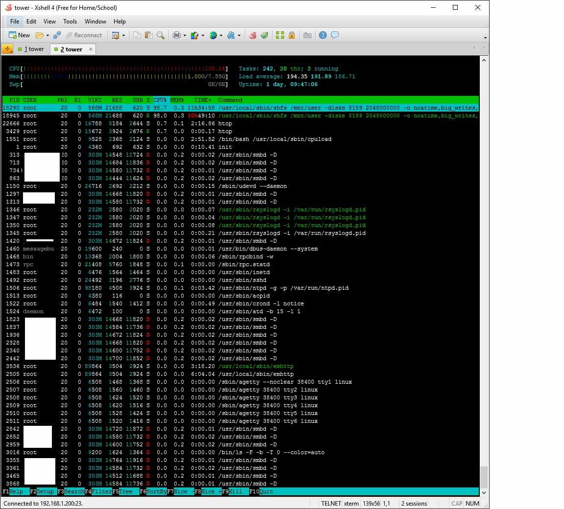

And we are back to shfs at 100% cpu.
However this time it's not zombie.
Also no smbd processes.
Can I try something during this state to help troubleshooting?
Syslog is clean.
Still no joy. Web and smb not responsive.
CPU is pegged with shfs (Htop screen included.)
/mnt/user0  &  /mnt/user  will not complete a simple "ls"
Neither "shudown -r now" nor "powerdown -r now"  will complete.
Still at a loss on how to troubleshoot.
Would greatly appreciate any UnraidTM Inc. input.
