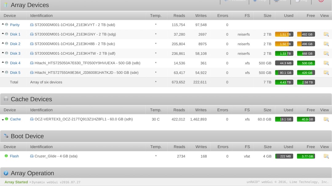

On Dec, 1st my server ran it's monthly parity check and emailed me that it had 20 errors. So I ran it again and a few hours later it returned no errors. I went about my day.
I log on to the GUI today and I see the orange triangle saying array is unprotected and noticed my Parity disk is missing. When I stop the array it is not an unassigned disk. I tried a different SATA and power cable. No luck. I can't pull its SMART either.

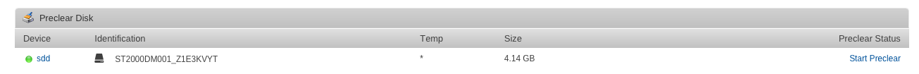

The weird part is, a disk with it's serial number shows up in the pre clear plugin page. I attached an image below. To make things even stranger to me, it reports a size of 4.14 GB for a 2TB drive. Is this normal?
Can I hit the pre clear button and see if things right itself.

Why can I see it under the pre clear plugin but not under unassigned?

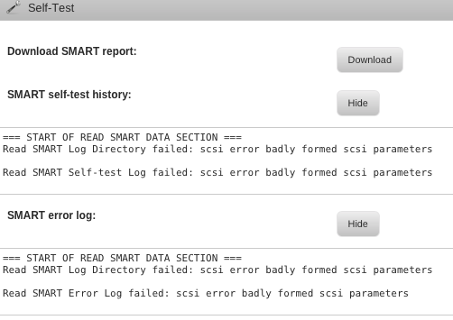

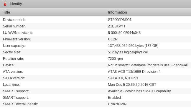

If I click on the disk's label (sdd) on the PreClear plug page, I get this info attached:
That disk looks like a goner.
