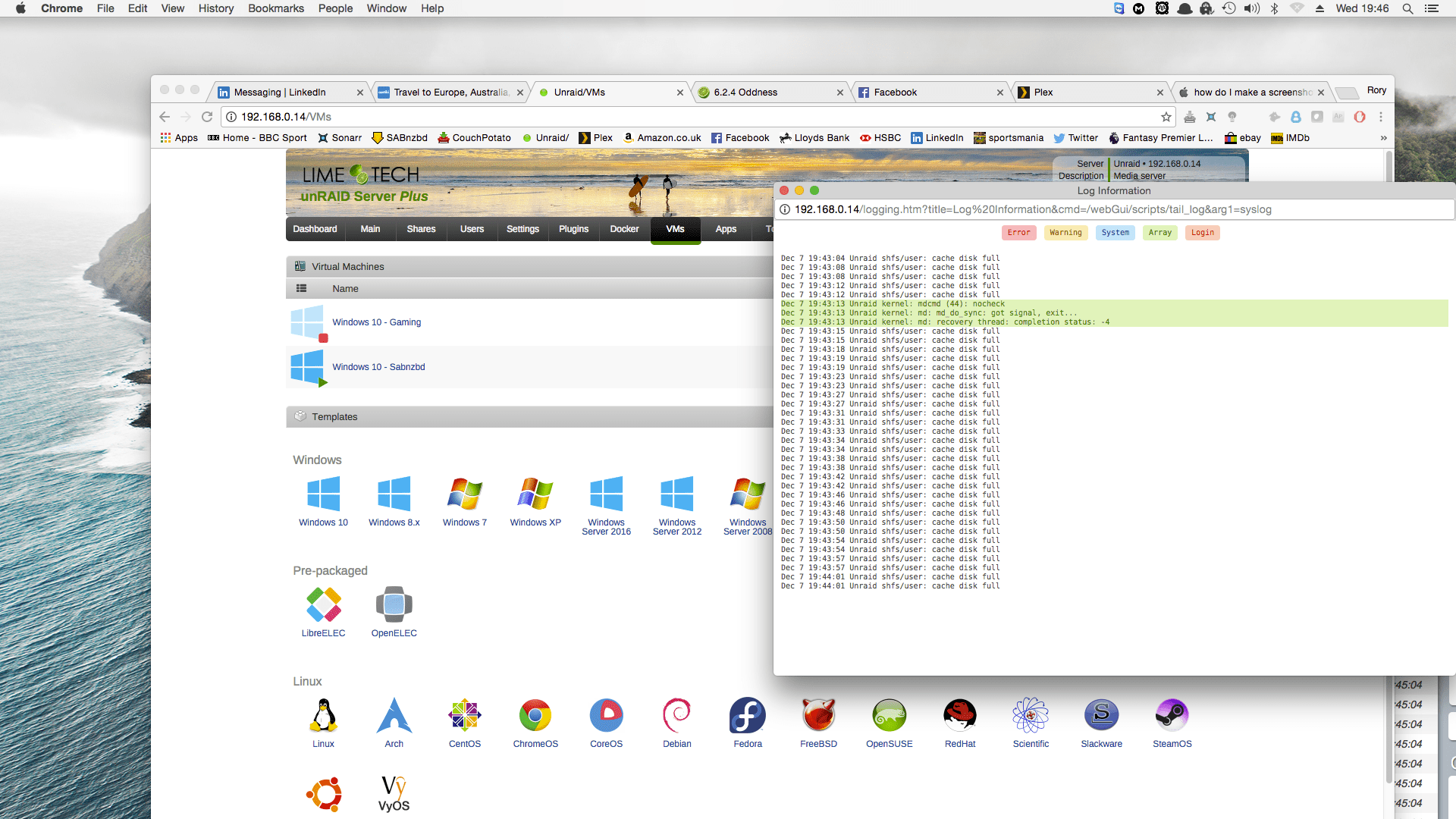

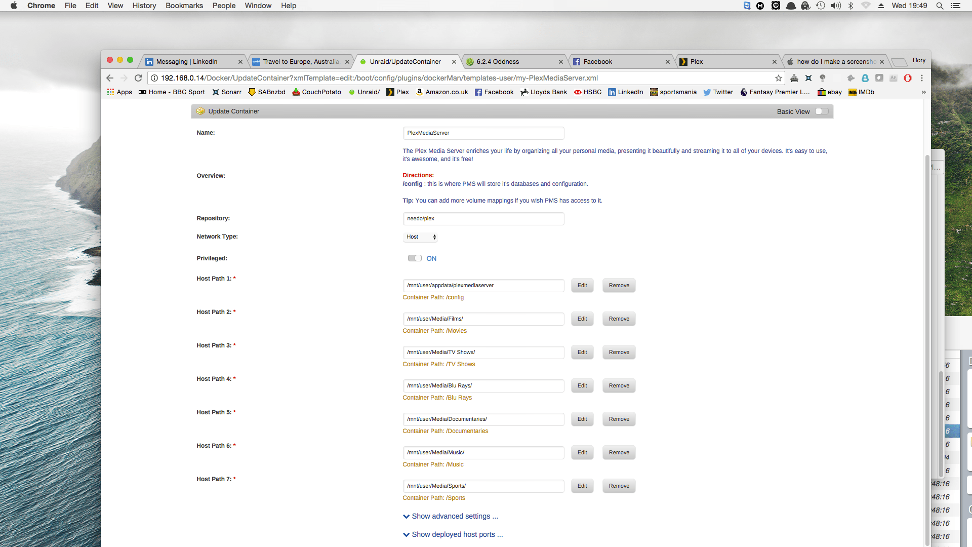

Posting diagnostics after this happens would be very helpful.  Also a screenshot of Plex's template (edit the container) would be great.
Hopefully you can see a bit more of what is going on with the attachments?
And another
Your cache drive is full.  Either run mover, or you've over-provisioned the VMs disk space

I rebuilt the needo pms docker.
Largely works, but some tv shows wont play - there was a problem playing this item - not enough disk space to convert item.
Any ideas why?
Any ideas why?
TBH, I'd switch over to either linuxserver's Plex or binhex's plex.  Not that it'll necessarily solve your problem, but those two are the absolute best supported Plex apps for unRaid.
But, it still sounds like you've got disk space problems on the cache drive and/or the docker.img file
