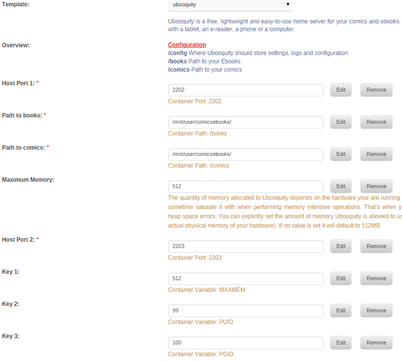

I've deleted the old Ubooquity folder, installed from the 'linuxserverio' default template.
I've added a screen grab of the books and comics folders I'm pointing at.
Not had trouble installing a docker in years...Am I missing something?

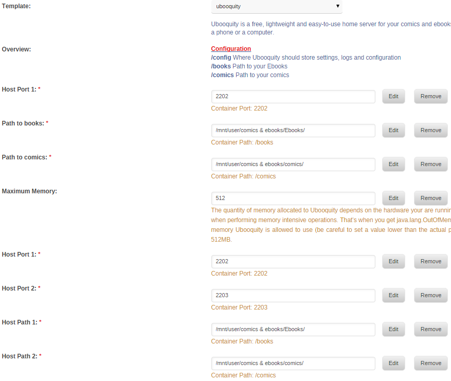

  • I just added port 2203 and now it works. By the looks of it you have to have two ports mapped 2202 and 2203. I noticed this in the sys log also: Fix Common Problems: Error: Docker Application ubooq
  • You don't need the port, that's the whole point of a reverse proxy.
  • If you need to open port 2202, you are not reverse Proxying the container. All traffic should go over 443 then.
Delete Host Port 1, Host Path 1 & Host Path 2, they are duplicates.
Path to books & path to comics are jacked, Both are mapped as /mnt/user/comics & ebooks/Ebooks/
I'm guessing /mnt/user/comics is probably correct, so just define where your books are.
You Sir are a wonderful person!
Changed my folder to one string name and followed your instructions.
Working fine.
Thank you.

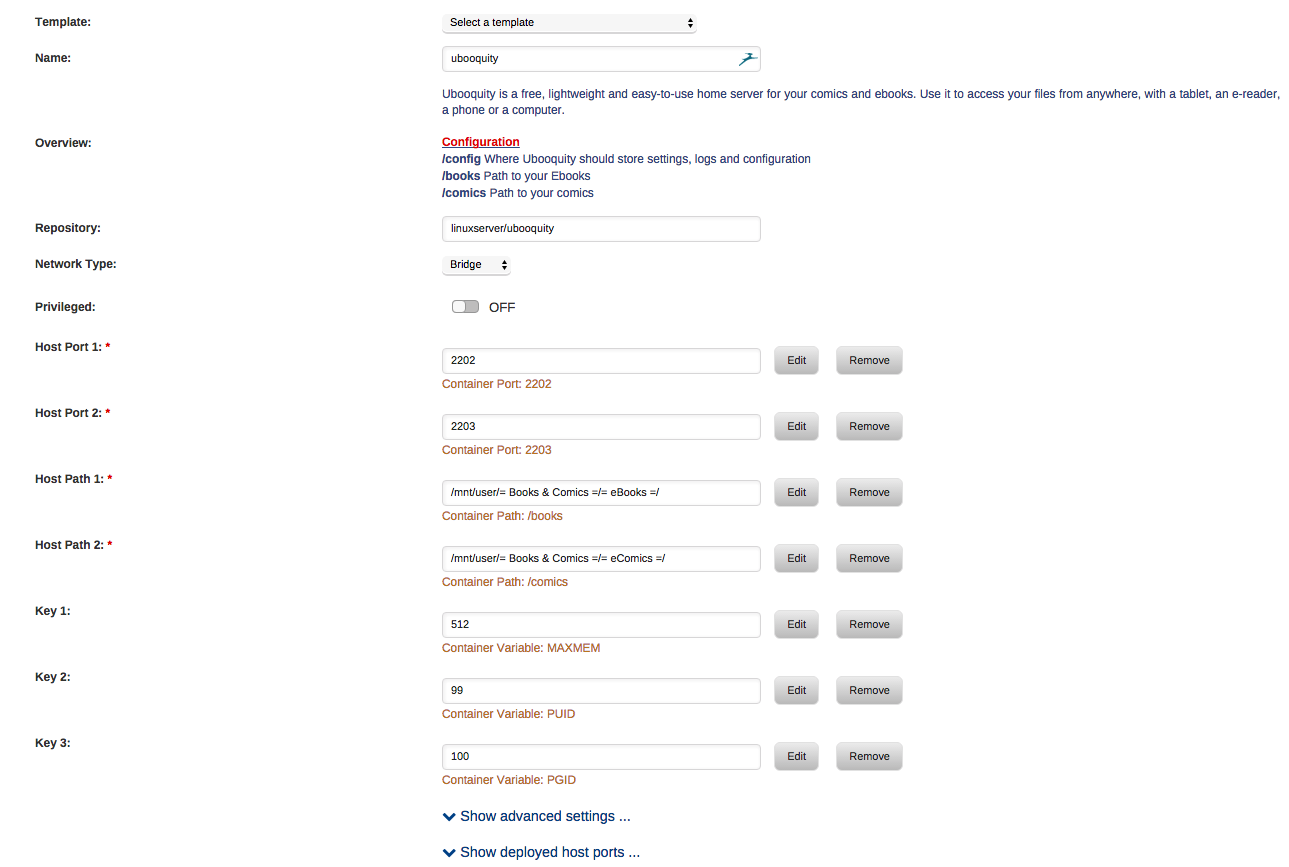

I've been at this for hours and stuck with this error message:
Warning: SimpleXMLElement::addChild(): unterminated entity reference Comics =/= eComics =/ in /usr/local/emhttp/plugins/dynamix.docker.manager/include/CreateDocker.php on line 211
Command:
root@localhost:# /usr/local/emhttp/plugins/dynamix.docker.manager/scripts/docker run -d --name="ubooquity" --net="bridge" -e TZ="America/Los_Angeles" -e HOST_OS="unRAID" -e "MAXMEM"="512" -e "PUID"="99" -e "PGID"="100" -p 2202:2202/tcp -p 2203:2203/tcp -v "":"/books":ro -v "":"/comics":ro -v "/mnt/user/appdata/ubooquity":"/config":rw linuxserver/ubooquity
/usr/bin/docker: Error response from daemon: Invalid volume spec ":/comics:ro": Invalid volume specification: ':/comics:ro'.
See '/usr/bin/docker run --help'.
The command failed.

So you can't have spaces in the path name? That makes no sense at all since all my other Dockers have no issues with spaces.
Warning: SimpleXMLElement::addChild(): unterminated entity reference Comics =/= eComics =/ in /usr/local/emhttp/plugins/dynamix.docker.manager/include/CreateDocker.php on line 211Command:root@localhost:# /usr/local/emhttp/plugins/dynamix.docker.manager/scripts/docker run -d --name="ubooquity" --net="bridge" -e TZ="America/Los_Angeles" -e HOST_OS="unRAID" -e "MAXMEM"="512" -e "PUID"="99" -e "PGID"="100" -p 2202:2202/tcp -p 2203:2203/tcp -v "":"/books":ro -v "":"/comics":ro -v "/mnt/user/appdata/ubooquity":"/config":rw linuxserver/ubooquity/usr/bin/docker: Error response from daemon: Invalid volume spec ":/comics:ro": Invalid volume specification: ':/comics:ro'.See '/usr/bin/docker run --help'.The command failed.
59e17b5657ab9_ScreenShot2017-10-13at19_46_46.thumb.png.1e9606fc5335b4ce99c912493876ede4.png
It's not the space. It's the ampersand causing problems

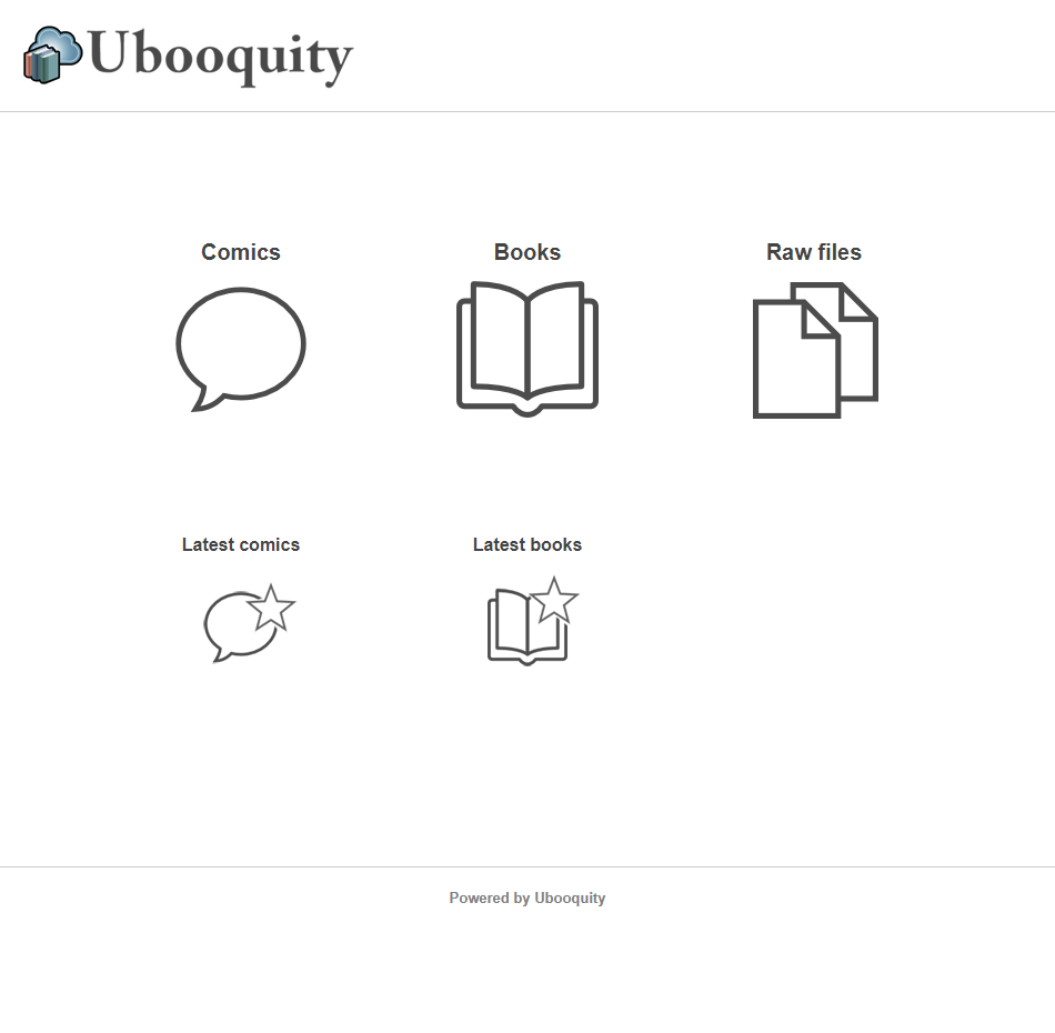

hi
new here
installed ubooquity
started the docker
but i dont see any books
shouldt i be able to run a scan or something?
i only see, when i click the webui, comics, books, raw files, latest comics and latest books
Where is my settings page or something
thx in advance
hi
new here
installed ubooquity
started the docker
thx in advance
Read the readme on github, all will be revealed.
