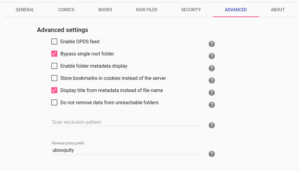

That config is correct, don't forget you need to restart letsencrypt after modifying the default file and you also need to set the reverse proxy prefix as well in the ubooquity admin config.

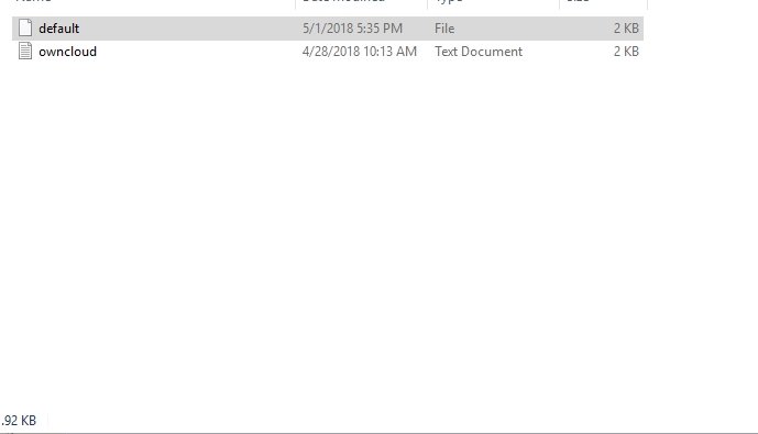

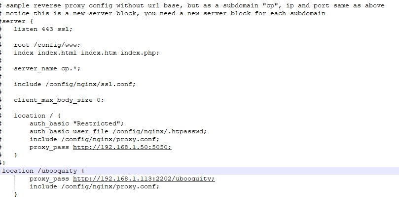

ive included screenshots of my ngix folder and of the default file and my very last post there is a problem in the logs the message im getting is

There's an error in your default file on line 72 which is stopping nginx from starting
what i had on line 72 was
location /ubooquity {
		proxy_pass http://192.168.0.1:2202/ubooquity;
		include /config/nginx/proxy.conf;
was this wrong ?

If that doesn't work you need to paste your file so I can take a look, screenshots are no good.  Also that owncloud file shouldn't be a .txt file, it shouldn't have a file extension

There's no ubooquity config in that

On line 49 you have the closing bracket and you've posted the ubooquity config below that, it should be above the closing bracket.  You need to be really careful about where the brackets are otherwise, like you've found, the file breaks.

In admin, advanced settings, remove the reverse proxy prefix
Many thanks, that seems to work, I did try that before and it looks like it doesnt work because when you click on the WebGUI link it still sends you to http://192.168.1.228:2202/ubooquity/admin hence although it was working it looks like it doesnt work :(
