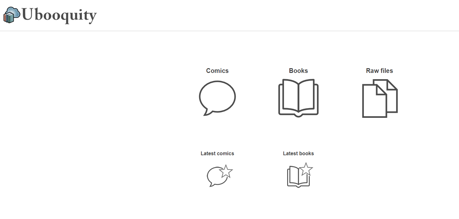

i have ubooquity working now. but i cant login to my user.
when i disable the security i can access it but i cant see anything. i only see comics books raw files and so on but when i click it it doesnt do anything.
i dont even se the symbols underneith the text from comic books and so on.
Edited by stFfn
its still looking like this when i open it with an external link. even after chaning to DNS authentication with cloudflare...
but if i open it localy it looks like this...
any ideas? 😕

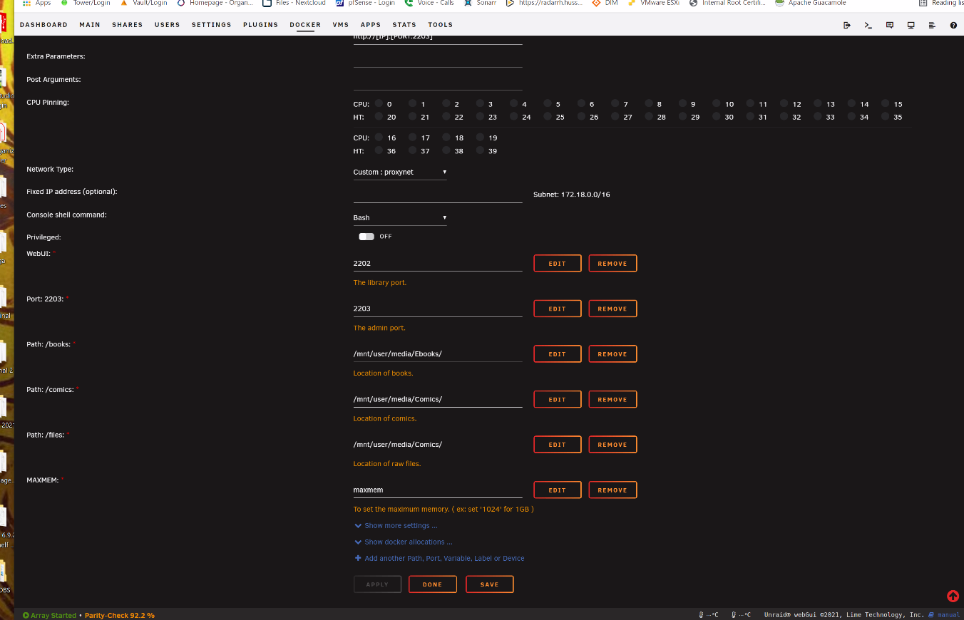

Hello i am Having an issue with ubooquity docker and thought re-installing it would resolve my issue, the template has changed since i installed it some time ago. i followed my old template as much as possible but where should path /files be pointing ?image.thumb.png.958acbe74ba067996cfe3b7fb56bf851.png

The fix for the error is to set a MAXMEM size(MAXMEM is not a valid entry, must be a number), I set it to 1024 and viola it worked.
