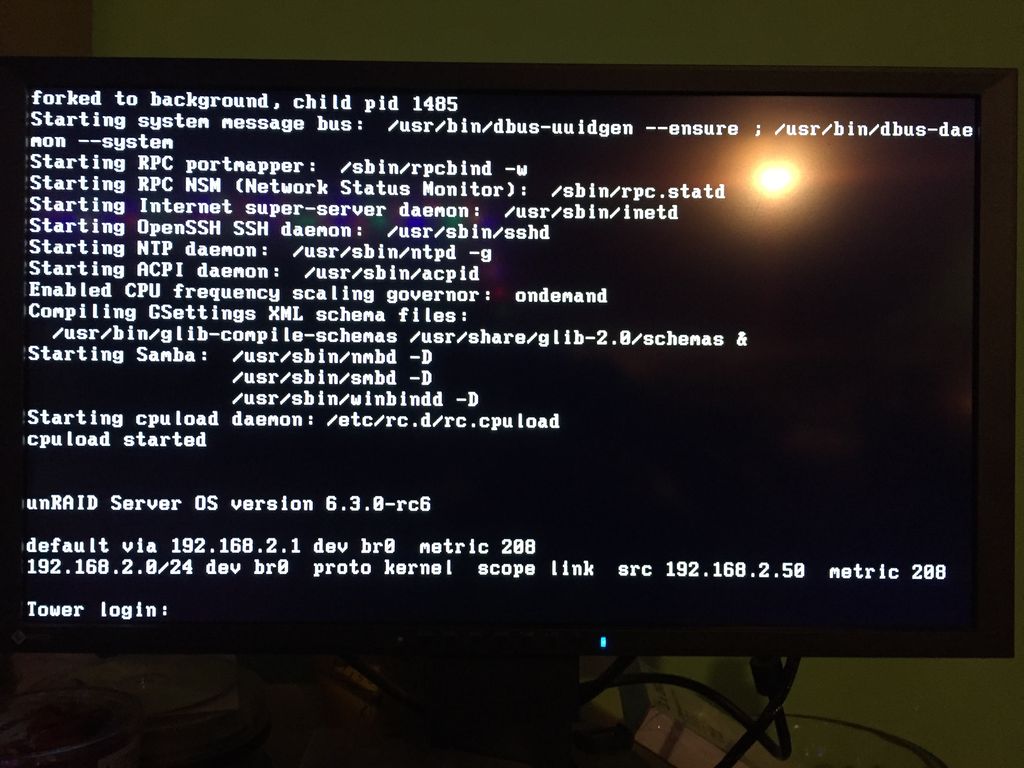

5) When system freeze, I cannot login over SSH, even cannot ping - when I check monitor, there is only last message from startup of system and seeing login into tower - its unresponsive, typing on keyboard not seen in console

I am attaching Fix common problems - syslog & diagnostic
In next post I attach how screen looked like after freeze & Also attaching HDD's S.M.A.R.T status logs.

I already put diagnostic and it shows nothing. I also attached screenshot which shows how unraid looks when freezed.
If you wanna help would be nice to look at logs I attached.

Unfortunately your syslog snippet just shows that the system presumably outright crashed.  The picture of what's on the display only showed what was normally there.  Usually, but not always, a software error would result in a kernel oops or something displaying on the screen.
Since there is very little information to go on, hardware tends to get blamed.  The only suggestion that I can offer is:

I did measure temp with Dynamix but values are max 39 degrees of centigrade.
I gave this unraid to my friend to make some tests and digging. He did various benchmarks (again in Windows) and they show that HW is perfectly fine.
From symptoms I dont know what to expect, there was no kernell panic on screen, console just freeze..
Whole HW is brand new including PSU which is 550W from Coirsair.
We will make several more tests, but starting to be desperate.
