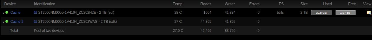

I have precleared a new drive and I have assigned it to slot 2.  I now see a cache pool.  I read in these forums that I need to run the Balance command / button on cache drive 1, so I did that too.  The balance is still running.
How do I confirm I have this setup correctly?  See attached screenshot.  Next to the 2nd cache drive, it doesn't show the same stats, like nothing under FS, so I want to be sure it was added correctly.
thank you.  From my screenshot, does it look correct?
Just to be sure, I ran the Balance command again.  I then ran the Scrub command, both on cache drive 1.  Everything looks ok, I guess.
yes
