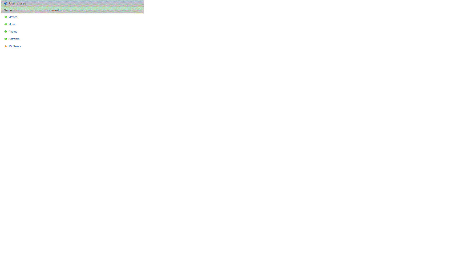

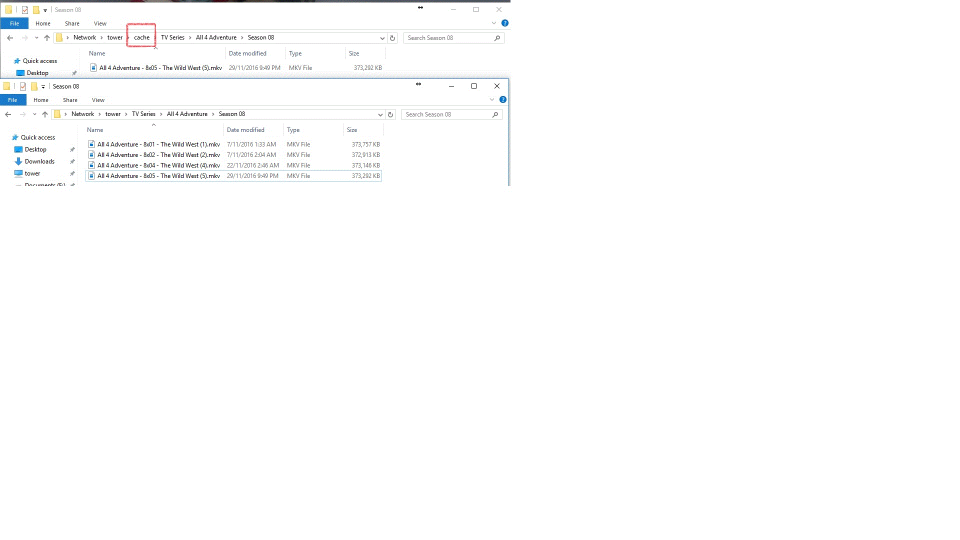

All of a sudden my sickbeard is writing to the cache instead of my 'TV Series' user share. Although it shows up in both locations(cache and user share), when I delete the file from the cache side it removes the file from the user share.

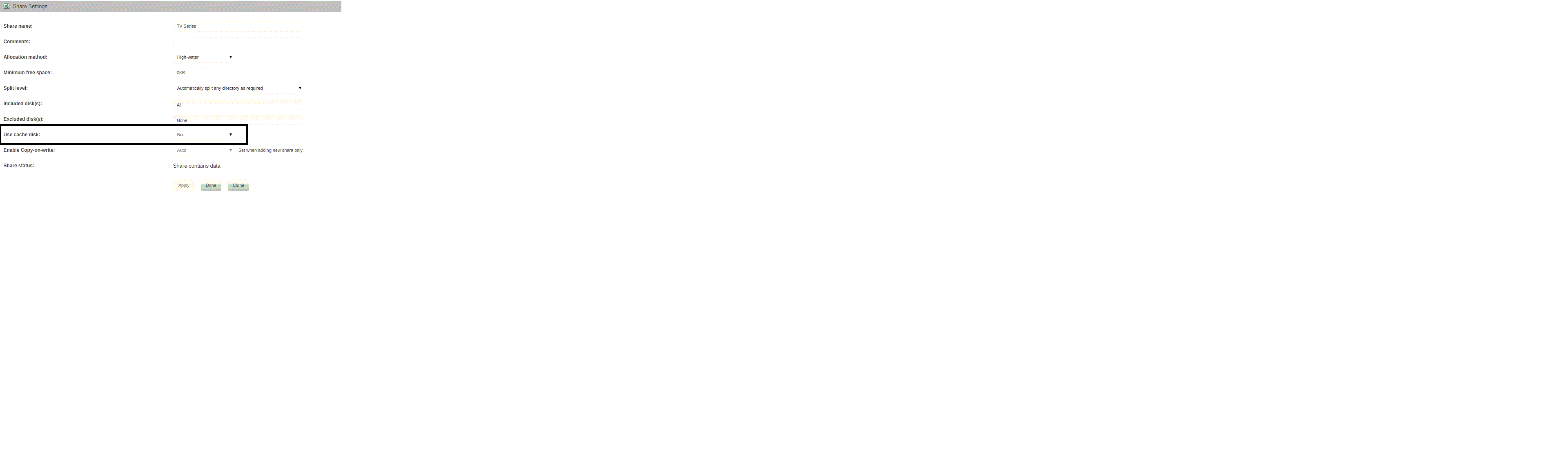

I have the yellow triangle next to my 'TV Series' user share but it is not configured to use the cache disk.
Attached is system log and some images that hopefully help explain my issue.

The /mnt/cache location refers to a physical drive, while /mnt/user is a logical view across all drives (including the cache drive).  This will be why deleting from /mnt/cache also removes the file from /mnt/user.  There is also /mnt/user0 which gives the logical view omitting the cache.

As you can see, the User share named "TV Series" is on cache.
Set that user share to Use cache: Yes, run mover, then set it back to Use cache: No.
Mover will not move a cache-No share. It only moves cache-Yes shares from cache to array, and moves cache-Prefer shares from array to cache.

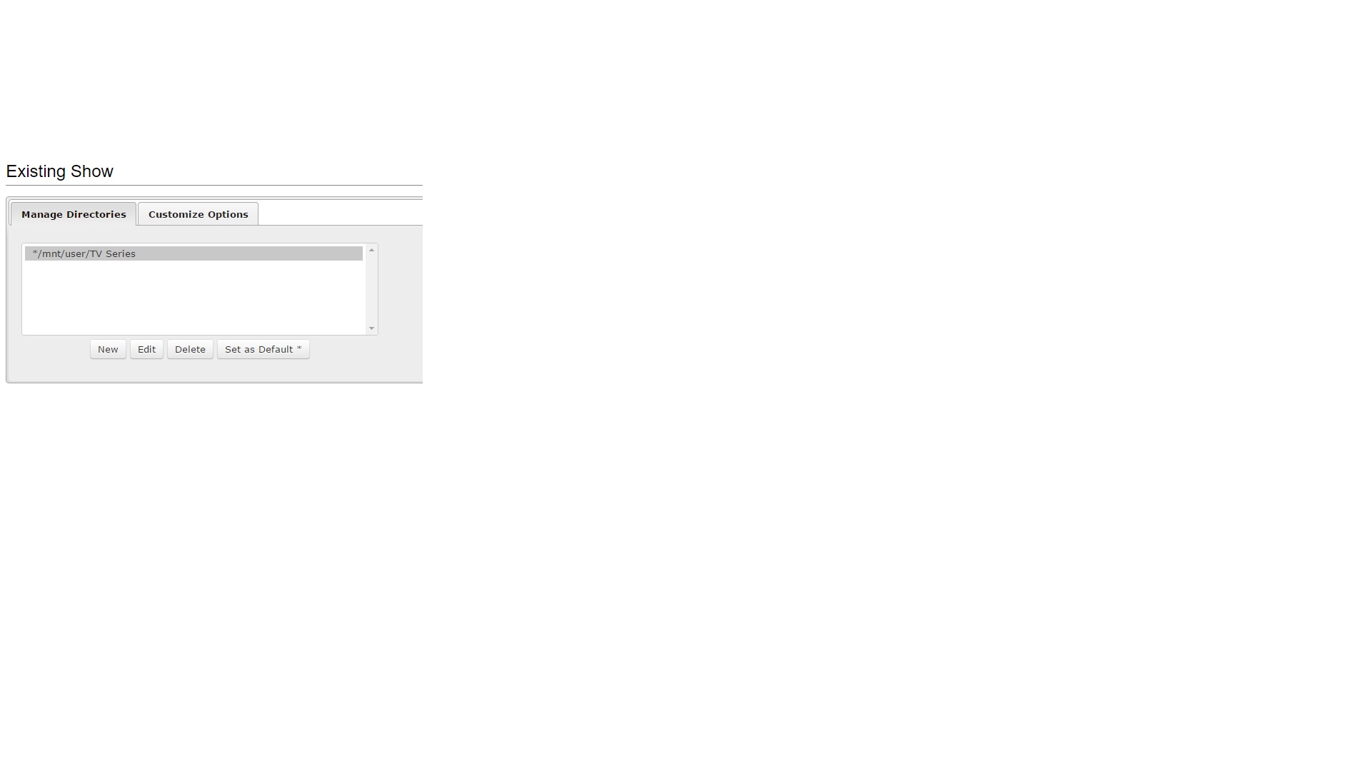

the root directory for SB is;
Root Directories *
Edit /mnt/user/TV Series => /mnt/user/TV Series

I have gone into SB and redone the following; but it is not the first time I have done it and SB has never point to cache previously; (SB is Phaze's plugin)
Root Directories *
"Root Directories" like you are describing isn't a SickBeard setting so it must be something to do with the plugin settings???
What does Sickbeard show here?
Go to a show that is on the cache disk and see what is under the location here?
This is a Docker so /tv is mapped to the user share by the Docker settings.
Attached is where SB is looking at.
All my shows have this(/mnt/user/TV Series/) location set as their location. And any new episode is being written to the cache.
