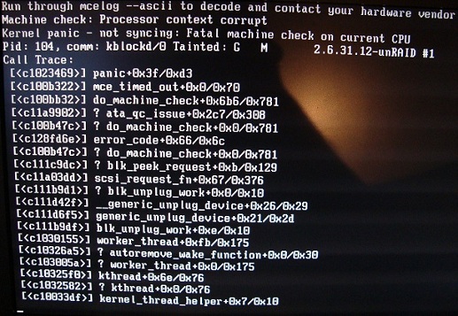

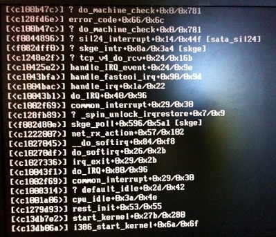

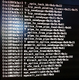

It took me a while to fiqure out whats going but if i put load on the machine the following happens, (please excuse the photos they are the only way to show the output as its not logged to the syslog. Also attached are 2 syslogs.

hrrrmmm the plot thickens, I didn't buy that my mobo was completly dead yet so on the bench I added 2 sata drivers and just used the free version of unraid, started parity -> crash, stuff around with the NICs and changed to the onboard=no diff, then i moved my disks off the SIL3132 controller (onboard) onto the native Sata controller = parity works, so i moved it back to the SIL controller = just about instant FAIL.

I can confirm that regardless of version,if there is a sata disk connected to the onboard Silicon Image controller Unraid will crash/Kernel Panic.
Just to reiterate this config has been running successfully for nearly two years so I'm reaching but I'd say something to do with the controller has bit the dust.
