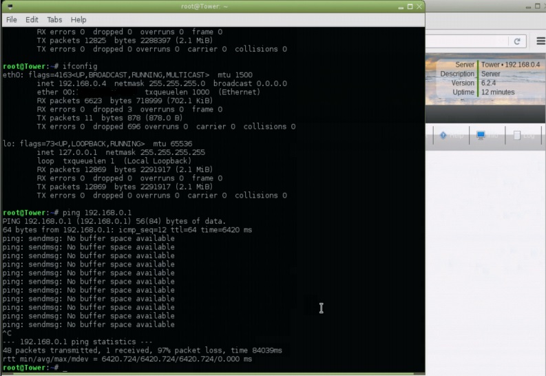

i am looking at ifconfig on the server and noticed lots of dropped packets
then when trying to ping "no buffer space"
any ideas ?
i have attached screenshot

Your previous picture shows only eth0 (=single port). Is this while both NICs are still installed? If so, remove the 2x1 NIC and test again.
Perhaps testing with a single NIC installed might be a good idea anyway.
this is a dual port nic - i have disabled the other interface
i have also tried many single nic cards and another dual nic
the onboard nic is not visible to unraid
my original setup was 1x dual nic and 1x single nic
currently there is only the dual nic installed
... currently there is only the dual nic installed
That doesn't appear to work correctly, since there is no eth1 or did you disable that port?
yes i disabled the port
