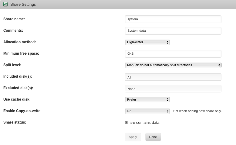

Hi, it seems that the cache drive is acting up. It is not moving the files from the cache drive even if the scheduler is on. I rebooted multiple times, ran manually the mover but when I look at the logs (attached), it looks like it try to move the file to the cache drive itself instead of moving it to the shares. Ex. moving "system" to cache
Any thoughts? As you can expect all my shares are shown as unprotected.

If a user share is configured with the "Use cache disk: Prefer" option it will do just as you describe. Since unRAID 6.2 that has been the default configuration for the system share. Turn on the webGUI help for more information.

You need to set your Media and Backup shares to "Use cache disk: Yes" instead of "Use cache disk: Prefer".
