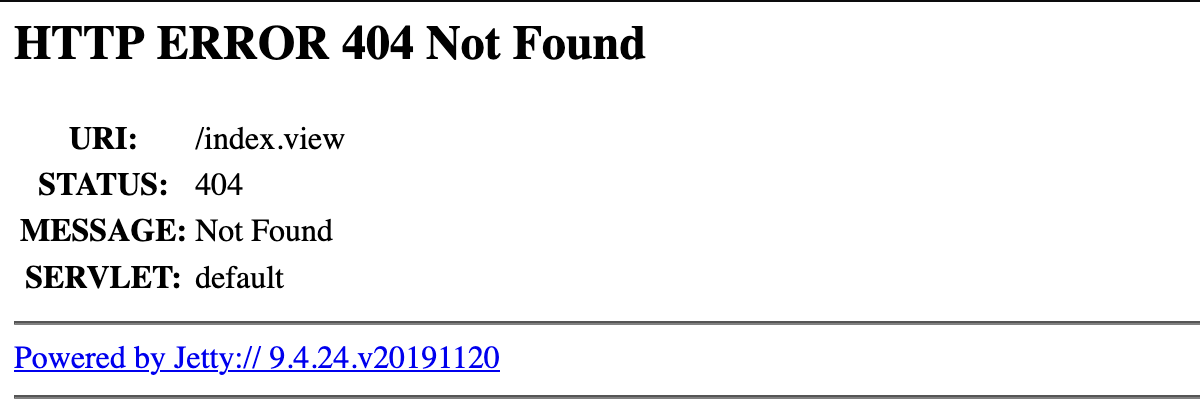

Good morning,
FWIW same error in container log with :latest tag, although a different result for me when browsing to the default page.
1308500844_ScreenShot2020-08-07at08_49_38.thumb.png.351bdea31d5c72c3149d5a4631eb16d6.png

Got a bit excited - forgot to upload error screenshot
Same problem as Del, I get a 404 error when I run the Docker. I’ve worked around it as per Moppen’s post, thanks for that.

Looks like there are some changes upstream so we will need to make some adjustments on our container. For now, please rollback to a previous tag.

Fixed image has now been pushed to the repo. It had broken due to the booksonic dev renaming the repo. Looks like they're rebasing booksonic on airsonic currently so we will switch to that once it is released.
