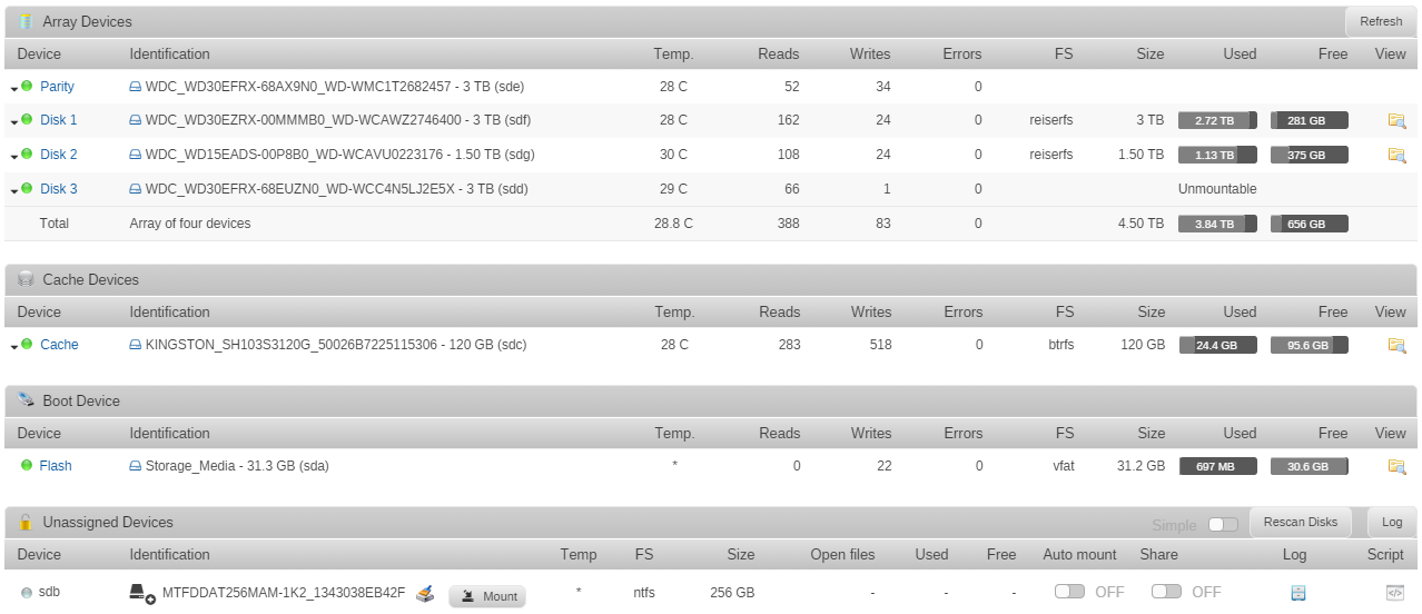

noob question - adding new drive - shows up as unformulated
so I forgot the format the drive before adding it to the array, now it shows up with a green dot when the array is started but also is unmountable. I'm not sure how I missed the formatting step.
what's my best course of action here? Do I need to take it out of the array to format it now? I dont see the format option anywhere at this point.

Go to Tools - Diagnostics and post the complete diagnostics zip along with a screenshot of Main - Array Operation.

thank you for your reply, please find attached.

Don't know if something happened to your screenshot, or if you just didn't understand what I was asking for, but you are missing the specific part I was asking for, Array Operation.
not sure what to say, I'd swear the format button wasn't there first time I started the array, I was specifically looking for it. I just managed to format it and operates properly now, thanks again...
