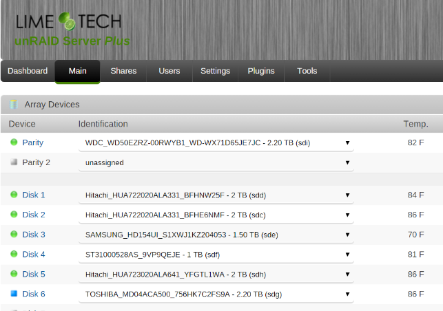

OK, I'm a complete newbie to unRAID, but think this is the solution I was looking for.  Everything set up correctly and was easy to navigate.  But, then I installed some of my larger drives and I started having problems.

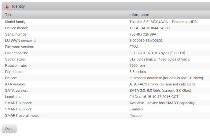

I installed 2x 5TB drives with the thought that one would be the parity disk.  But, I found that unRAID was only showing these as 2.2TB despite the bottom of the screen showing that they are 5TB drives (see attached screen shots).  I tried reading some posts on this and it seemed like there was a 2TB limit until you purchased a license.  So, I purchased a license thinking that I would automatically start seeing the extra space on these drives ones properly registered.

Most likely, the onboard SAS / Sata controller (ESB2?) only supports up to the 2.2tb (not an uncommon occurance the older you go).  Possibly a BIOS update might help, but you're probably going to have to add in a PCIe HBA
OK, thank you for pointing me in the right direction.  I had previously thought it was a setup problem, but it seems like I have a hardware limitation now.
My mainboard has this SAS chip embedded: LSI SAS1046E
Founnd elsewhere on the web in relating to this controller:  "The big problem with the 3Gbps cards is the 2TB size limit."
