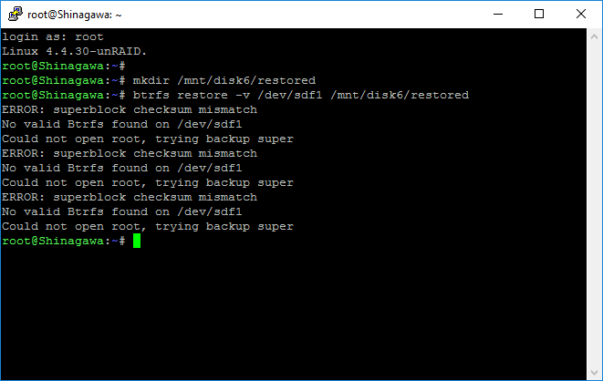

You're going to try btrfs restore first, it can take longer but it's non destructive, disk6 is almost empty so you'll use it as a destination, with the array started drop to the CLI and create a folder:
mkdir /mnt/disk6/restored
Then:
btrfs restore -v /dev/sdf1 /mnt/disk6/restored
If it works you'll see the list of files being restored, it will take some time as all data from disk5 (about 2TB) are copied to disk6, if it doesn't post all the output.
The four words of your guidance that I don't understand: "drop to the CLI." I took a look at every tab in the GUI, and I don't see "CLI" or "console" or "command line" or anything of that sort.
Actually, that's not accurate: I understand all the words; I just don't know how or where to find the command line interface. I did a Google search, but all I got was old references to SSH and Telnet and stuff that's obviously irrelevant.
As an aside, one of the reasons I chose unRAID instead of something like Amahi, was so that I didn't have to type a bunch of Linux commands to get stuff done. This is, of course, a special and specific case where I'm happy to poke around under the hood a bit. But you're going to have to dumb it way down, I'm afraid.
You need to SSH into the server, google Putty.
Forgot to tell that you that if you have a monitor and keyboard or IPMI on your server you can use those instead of SSH.
OK, got puTTY. I think I'm logged in as root/<none>. Tried the btrfs command. Doesn't look good/right. Screenshot attached!
