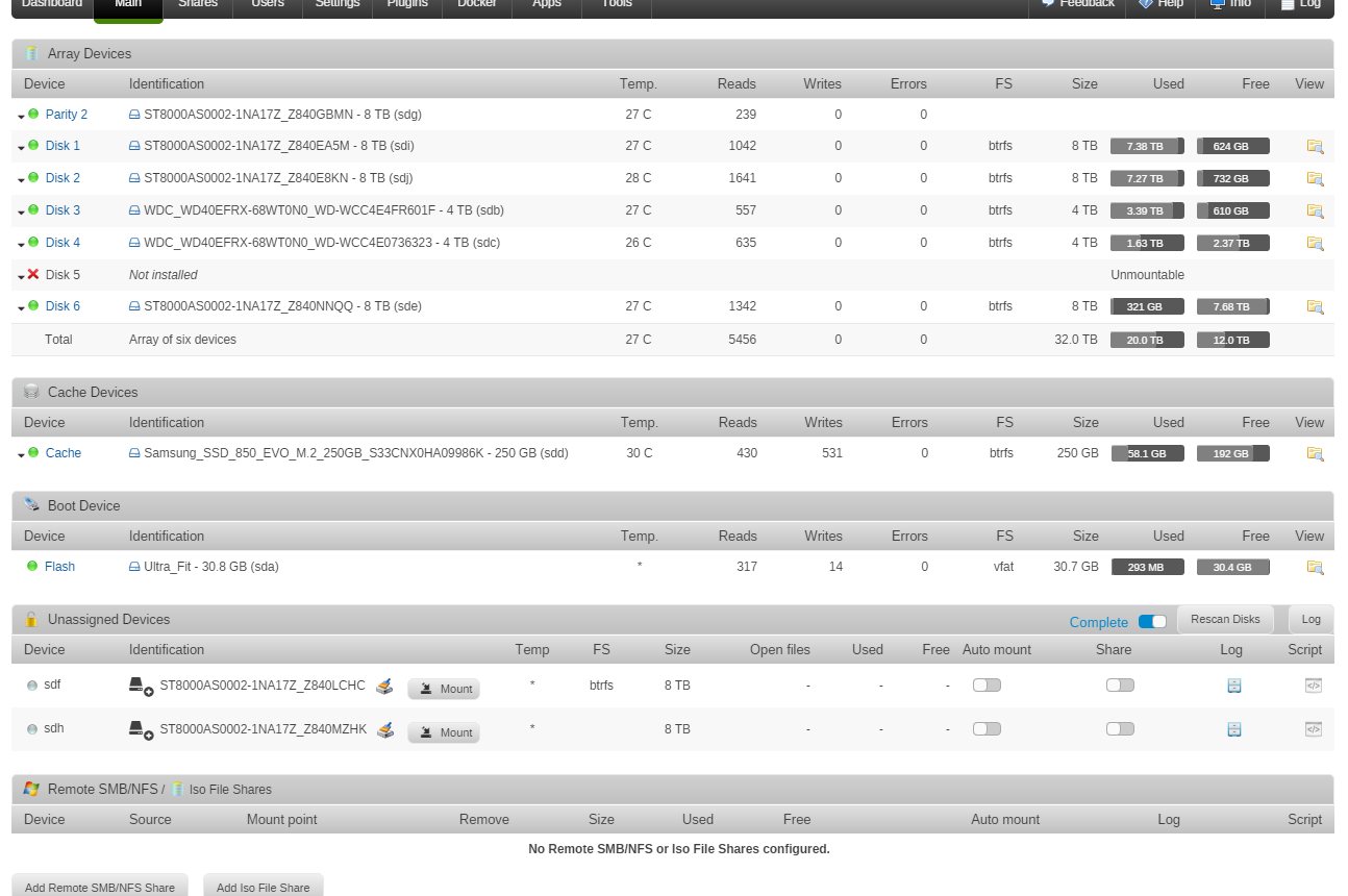

Post a screenshot of currant array so it's easier to see current state.
Oops! Meant to; had it all ready to go, and then didn't attach it.

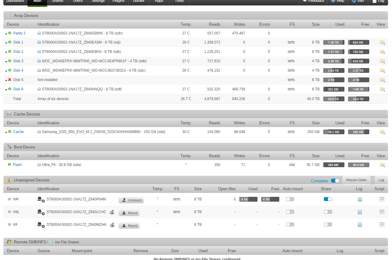

So disk5 is monted after all, I though it was still unmountable, looks like you copied the info to the emulated disk.
Also it's a little odd that both the emulated disk5 and the old disk5 have the exact same used space.
Are the other 2 unassigned disks parity and disk5 replacements?
This doesn't make any sense at all to me. I didn't do anything dumb when copying—I followed your instructions exactly. The 'restored' directory we created was created without any Disk 5 in place! And I mounted the old Disk 5 in Unassigned Devices, not as part of the array! What part of this doesn't unRAID understand?!? If anything screwed up here, it's unRAID.
Yes, the other two unassigned disks are the unsuccessful disk5 rebuild (-LCHC) and a parity replacement (-MZHK).
I've noticed some weird BTRFS behavior before, eg, when re-assigning a btrfs cache disk to the array, so just to make sure that the data is really on the array, shutdown the server, disconnect old disk 5 and power back up again.
Shut down. Disconnected (SATA, power) old Disk 5. Restarted array. The 'restored' directory is there, but not all of the sub-directories or all of the files. Some are, but some aren't. Another screenshot is attached.
I'm satisfied that I can get almost all of the files off the old Disk 5 when I want to, but I guess the BTRFS weirdness should be solved first? Unless there's a way to force a copy onto other-than-old-Disk-5 array space?

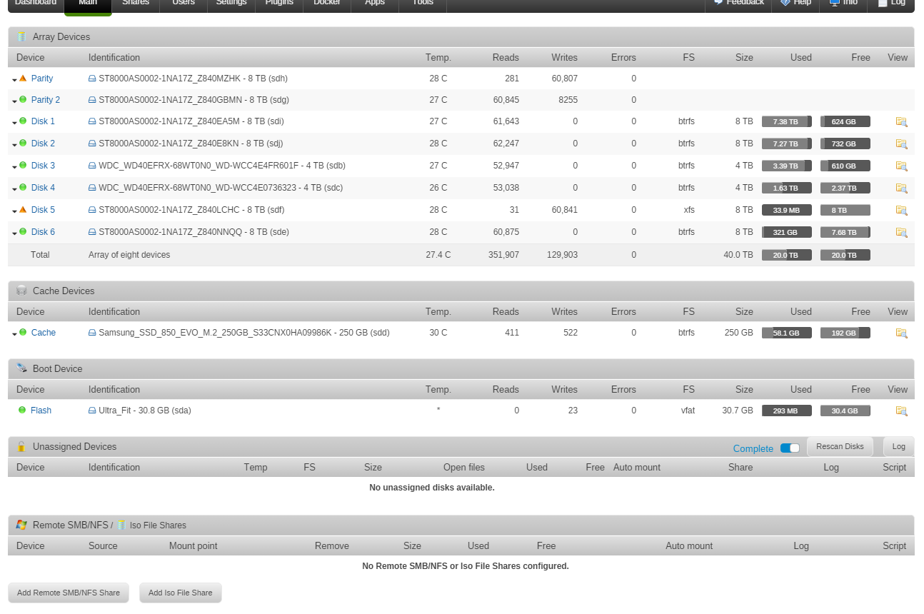

Parity rebuild started. (Note: When I did the New Config, there was no explicit, simple "Keep current assignments" option. In the sub-menu of checkboxes for "Keep current assignments," I selected "All.")
New (-LCHC) Disk 5 installed, formatted XFS.
But what's the orange triangle beside Disk 5 doing there, saying "Device contents emulated"? I thought the point of formatting (especially formatting XFS rather than BTRFS) was to blow away whatever Disk 5 history there was?
You didn't click apply on new config, instead it's rebuilding disk5 again (and syncing parity).

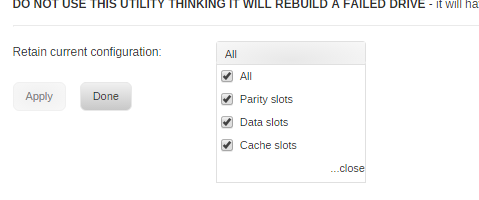

Interesting. Figured something out:
You know why I didn't click on 'Apply'? Because it was greyed out. Do you know why it was greyed out? Because I hadn't clicked on the checkbox for 'Yes, I want to do this.' Do you know why I didn't click on 'Yes, I want to do this'? Because I didn't see it. Do you know why I didn't see it? Because it was covered up by the secondary checkbox for 'Keep existing configuration.' Do you know why it was covered up by the secondary checkbox? Because I didn't click on '...close' at the bottom of the checkbox. Do you know why I didn't click on the '...close' at the bottom of the checkbox? Because I didn't know I needed to. Do you know why I didn't know I needed to? Because the interface design for this task is poor.
It's pretty dumb to cover up an important part of the UI ("Yes, I want to do this") with what looks like a wholly optional step ("...close"). Especially when there's an ambiguously-titled button ("Done") to click that doesn't then actually apply changes.

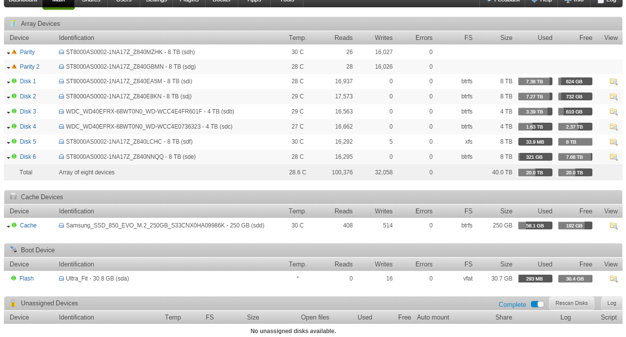

OK, this looks better, I think. Both parity drives rebuilding, Disk 5 with a nice green dot.
I didn't get a chance to re-format Disk 5 during this cycle. Clicking on 'View' shows nothing on the drive, though. I imagine by canceling the original parity check and rebuild, that leaves Disk 5 back where it was immediately following the XFS format step?
Yes, looking normal.
