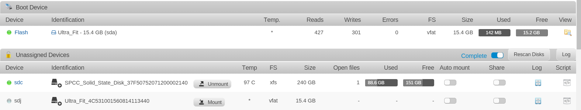

My unraid boot device shows up as unassigned after a few hours of running. This issue has been driving me crazy so I decided to just do a clean wipe, I wiped all my drives (taking over 16 hours) wiped the boot usb and re-installed unraid and then I set everything back up again. I am on a trial key. I let the parity sync run and it completed without issues.

The reason this is an issue is because before the wipe, eventually something tries to access something on the boot usb and then errors occur and then things start crashing (like the VM)
I don't even know where to start with finding the issue and I would be really grateful for any help

It started as sda, then showed up later as sdj.  That means it lost the connection, and later reconnected.  This is serious, as you'll have all kinds of problems when unRAID loses the boot drive, as it has above, because it will still expect it to be on sda, will never see it on sdj.  drawde's suggestions are good, try a different port first, and make sure it's well seated.
I really appreciate the replies. I had already tested different ports on a seperate bus on my motherboard so I doubt that is the problem, I am currently trying a different USB and I will report back as soon as I know
