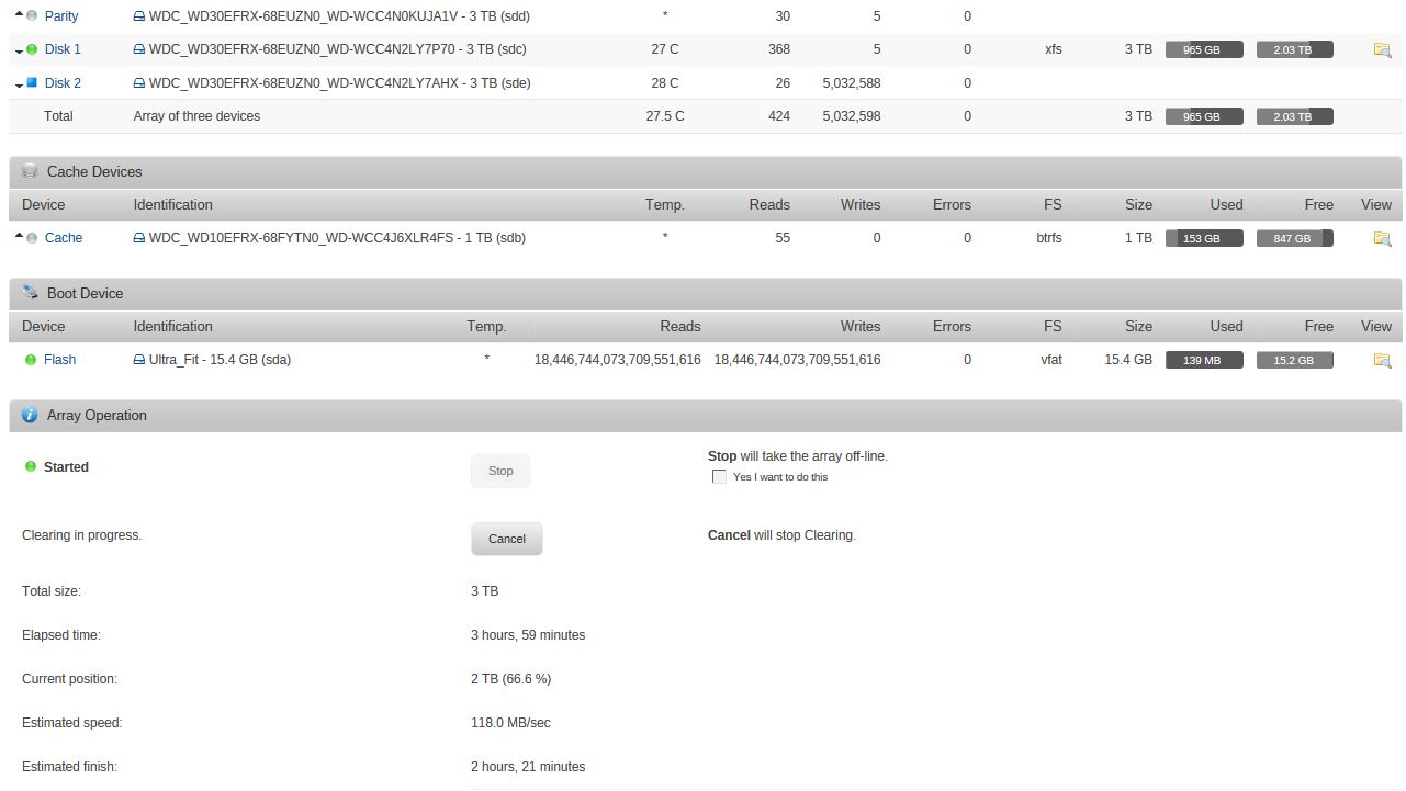

I have had to power down a few times when the GUI locked up.  Also, I noticed yesterday that the reads/writes to the boot USB were in the xx,000,000,000,000,000,000,000 area.  Yes, I ran out of prefixes to verbally express the qty.  I will yank the front panel USB/card reader and then do some diags on the USB boot.  Perhaps it has been written to so much it has failed?  Can't imagine why that would be though.

Here is the whacky report on writes/reads wrt the flash drive ...
Now the write is back to 4, while the read is still the whatever-is-after-peta-bytes number.
I think unRAID is not liking your flash drive or the port it is in somehow. Do you have another?
There are other USB 3.0 ports on the mobo.  Perhaps I have it in one that is a 3rd party, i.e. Asmedia or Via as opposed to those on the Intel chipset.  I will check that.  Plus I have seen suggestions that the the boot stick be on a 2.0 instead of 3.0.  If making sure it is on the Intel chipset doesn't help, I will rig a 2.0 port.
