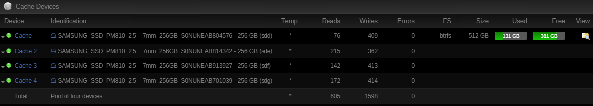

My Cache Pool is consist of 4 drives. (See screenshot attached)

Make note of each disk's identification information.
i.e. Serial number and device identifier highlighted in bold.
We'll need this to lookup in last few steps when re-arranging cache pool.
SAMSUNG_SSD_PM810_2.5__7mm_256GB_S0NUNEAB804576 - 256 GB (sdd)
SAMSUNG_SSD_PM810_2.5__7mm_256GB_S0NUNEAB814342 - 256 GB (sde)
SAMSUNG_SSD_PM810_2.5__7mm_256GB_S0NUNEAB913927 - 256 GB (sdf)
SAMSUNG_SSD_PM810_2.5__7mm_256GB_S0NUNEAB701039 - 256 GB (sdg)
