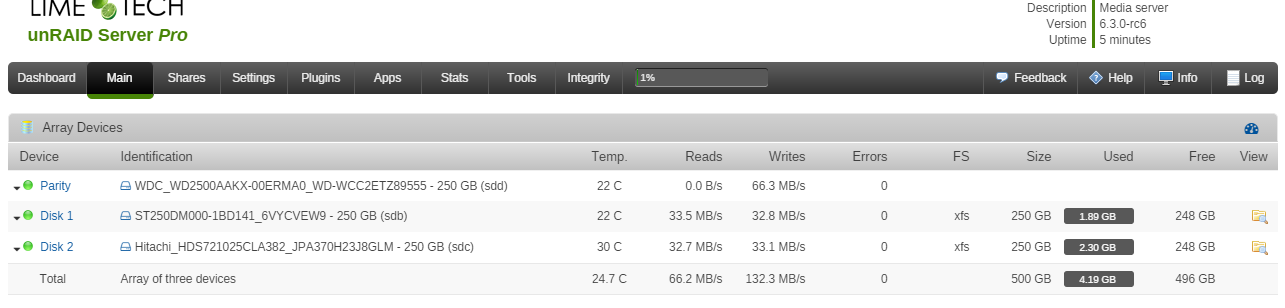

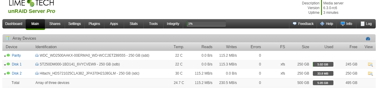

See examples below, writing over gigabit with turbo write, the actual writing speed is the parity reported speed.
