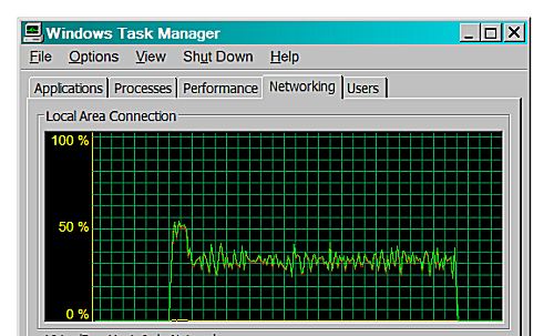

Preliminary testing... sustained 40MB/sec writing to parity protected drive over the LAN.... no spikiness.   ;D
Here is the mpstat output, while I copied a 3GB ISO file in 1min 16 sec:
08:15:26 PM  CPU   %user   %nice    %sys %iowait    %irq   %soft  %steal   %idle    intr/s

Also attached is a graph of network IO.... no spikiness
bubbaQ,
Is that with to user-shares, or disk shares?
If user-shares, is there a cache drive configured?
40 MB/s sustained writing performance over the LAN is outstanding!!!!!!!!!!!!!!!!!!!
On a disk share... I don't use user shares.

Seems I bought a AOC-SASLP-MV8 just at the right time :D
Stuck it in my server replacing my Si3114 card, and added a new Parity disk.  Parity is now building at 70mb/s  (5 drives on the motherboard, 5 drives on the Supermicro card).  Quite an improvement over the 25mb/s I was getting while parity checked against drives on the Si3114.
EDIT : Speed is probably bottlenecked by my WD Green drives. (?)
EDIT2 :  This slightly odd sounding message in my syslog :-
