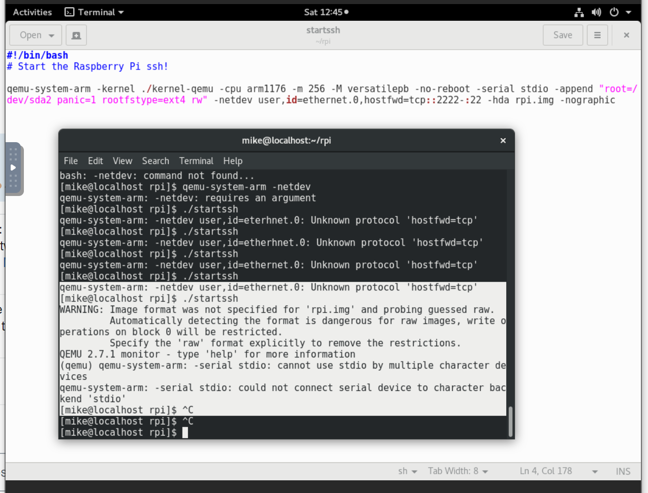

i got the to the part for the startssh..  but since  redir  has be depreciated  and replaced with netdev i been having issues trying to update it so i can get Raspberry running  and then upgraded to the latest version
im also r unning Fedora 33
would you happen to know the latest  code to alter it  so she will run   here is screen shot what i got
after the change i had to do for redir.. i did screen shot i having issues trying to get Copy and paste to work from the unraid  QEMU window  to windows and vice versa...
