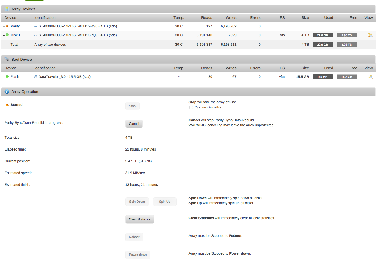

The problem/question I'm having is about the initial parity sync, since I think that it is going at a pretty slow pace. As you can see in the screenshot, I have setup one of the two disks as a parity drive, and is performing the initial parity sync. Is 30-35MB/sec normal in this case, or is there something that I should be doing differently? It have been staying around that speed since the start yesterday.
58aad842b1061_Skarmavbild_2016-12-30_kl._11_32_16.png.7f7662840df9b5ea973aab4ff9a3913c.png

With modern disks it should start @ ~200MB/s for 7200rpm disks and ~150MB/s for 5400rpm, speed will progressivly decrease as it goes to the slower inner cylinders and end at ~100 and ~~80MB/s respectively, this when there are no controller or other bottlenecks, like in that microserver with only 4 disks.

Hmm, okay, so then I'm correct in assuming that the speeds should be greater than what I'm getting? I'll let this parity sync complete first, then I'll have to check for that write cache setting in BIOS, and see if that could improve something. Btw, is parity check something that I could test the speeds with after the sync have completed? Also, is there any harm in starting a parity check, and then stopping the check?
Parity check speed usually = parity sync speed (though in this case if it's the write cache setting, parity check will be much faster because there's no writing).

If you have the write cache setting would should enable it to get better performance in any operation that includes writes, including parity sync and normal writes to the array.
That setting, at least on Gen7, exists and is disable by default for users without a UPS, it should be enable if there is a UPS, it's not recommend without one, but it's also not recommend to use unRAID (or any other NAS) without one.
