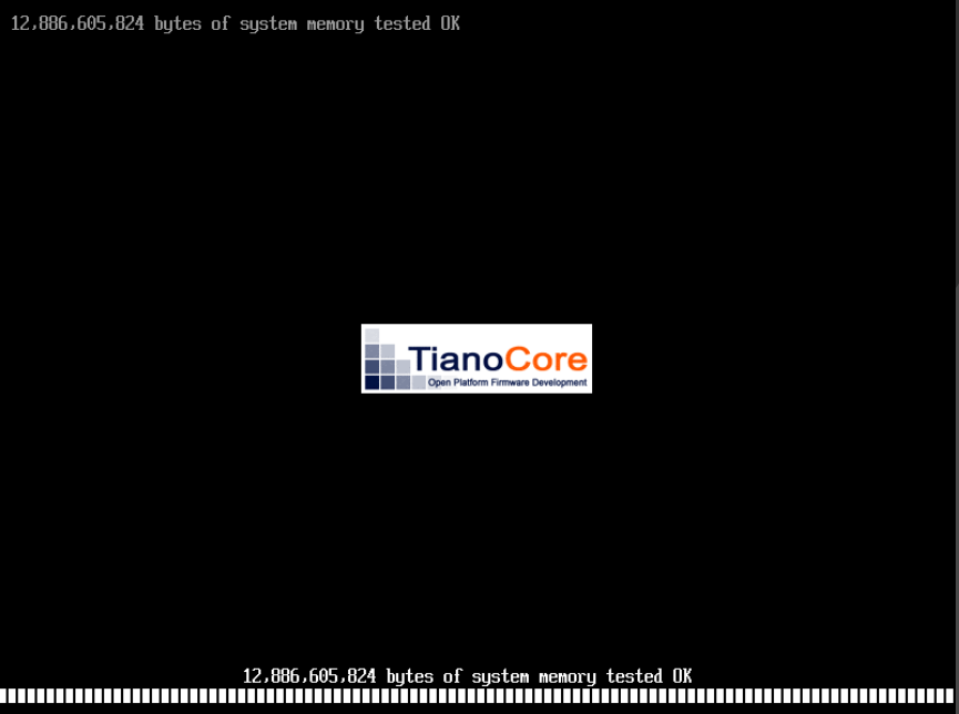

Running into a similar issue. I'm stuck at TianoCore and VM is unresponsive.
I tried both through the flash and manually in the XML, separate tests not at same time.
      <driver name='vfio'/>
      <source>
        <address domain='0x0000' bus='0x02' slot='0x00' function='0x0'/>
      </source>
    </hostdev>
I've attached diagnostics for those smarter than me, and a screenshot of my VM from VNC
unraid-box-diagnostics-20161230-1939.zip
