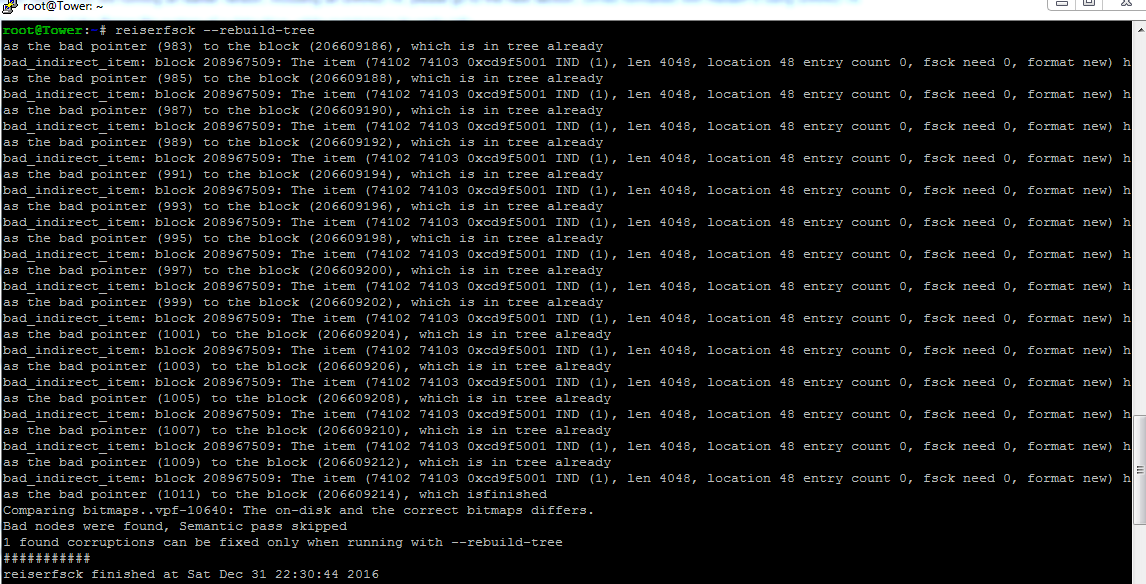

I ran the fix-fixable option on that disk. I then ran the -check option again and found a couple of more errors. I then ran the rebuild-tree option. Again ran the -check and more errors. I was basically in a loop.

When the rebuild tree finishes run another reiserfsck --check to confirm all is good now, I see no reason to replace the disk, SMART looks good, the problem was with the file system.
