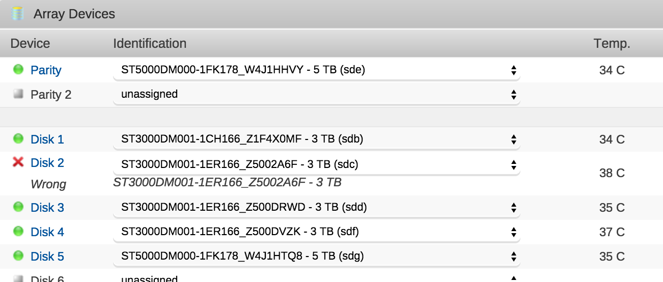

[Solved] "Replacement disk is too small" but didn't change anything
My array will not start with the error:
Stopped. Replacement disk is too small.	Start	The replacement disk must be as big or bigger than the original.
But I have not changed my disks at all. I just upgrade the RAM in this server and it has been working fine for months. While replacing the RAM I accidentally knocked out the power for one of my drives and so when I first started it up 1 drive was missing but after fixing the power it came back however a different drive is showing as "Wrong Drive" (It showed that way with the missing drive as well).
I didn't change the drive at all and I didn't want to go mess with anything before I asked here first. I attached my diagnostics and a screenshot of the issue.

Which seems to indicate the partition is missing on this drive

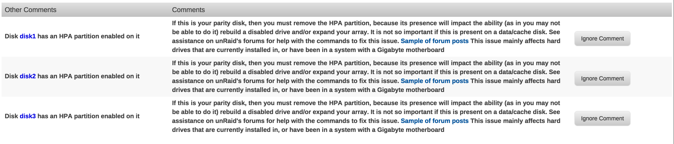

Just ran the Fix Common Problems plugin and found that 3 of my drives have HPA partitions on them so I'm looking into that being the cause of the issue but I don't know why that would just be happening now.

... Be sure the disk you remove the HPA from is the one that's now shown as "too small".  This won't necessarily be the disk that you knocked the power from => in fact, it's probably not.  I suspect the disk you knocked the power from already had an HPA; but when it wasn't "seen" during the boot process a new HPA was created on the next disk encountered during the boot process -- THAT is the one you want to remove it from.  It's easy to identify which disk you need to fix -- it's the one shown as "too small".
