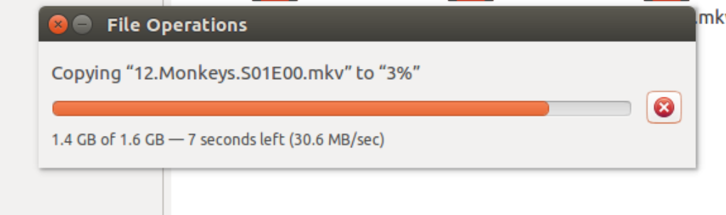

I should have stated in my previous post that I am already using the reconstruct write method. I just changed it back to read/modify/write and tried to copy a 1.6gb file, and I am getting on average 30 MB/sec.
Is this still a reasonable speed?
A little on the slow side if you're using modern HDDs but not by much, normal is around 40 to 50MB/s mostly dependent on the disks used.
Reconstruct write performs much better with writes from another computer, with disk to disk one of them will always be doing two simultaneous reads, never good for speed.
PS. Reconstruct write is also dependent on controller/bus bandwidth, it will never be faster than the parity check speed.
Yes, the speeds aren't bad -- as Squid noted, they're not "awesome" ... but reasonable.  If your array was all new, high-density (1TB/platter or higher) drives then I'd expect higher; but 30 or so is a reasonable expectation for most arrays.
I'm a bit surprised the reconstruct write didn't give better results -- but this is likely due to three factors:  (1) you're writing from a disk in the array to a disk in the array, so the reads result in extra seeks compared to writes from an external source (i.e. you'd probably get faster speeds writing from a network source); (2) the mix of your disks likely includes mixed densities; and (3) I notice you're using a pair of SASLP's ... with 8 drives attached these are limiting your bandwidth to the drives -- normally this would only be a factor with parity checks or rebuilds; but with reconstruct write you're also accessing all of the drives at once, so this would impact that as well.
Bottom line:  I don't think you have any issue to be concerned about.
