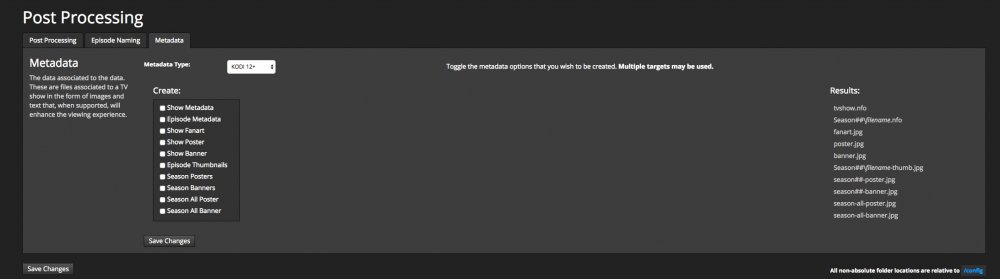

One more question about Medusa, when I was using Sonarr, it would grab metadata for an episode, nfo, thumb.jpg, fanart.jpg etc, currently its barely grabbing an nfo.
In the screen shot I have attached, do I have to check off the boxes on the left to get the metadata I want?
